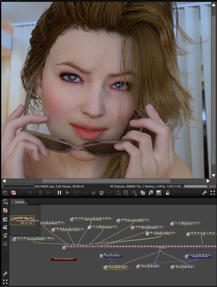

Tugpsx
Posts: 1180
Location: Chicago, IL
Quick question, although this may have been answered elsewhere.
Since saving shaders is currently disabled, can we create a script to export shaders nodes to ocm files that we can load and use later.
It would make life easier not to recreate the settings every time I use these characters. I know mine isn't as complicated as others but every bit help.
Material Node example.

Tugpsx wrote:Quick question, although this may have been answered elsewhere.
I don't think it's worth to create the script because we shall re-enable material macros in one of the next releases... . You could save your materials with Octane 1.20 for now, the macros are compatible with this version.
