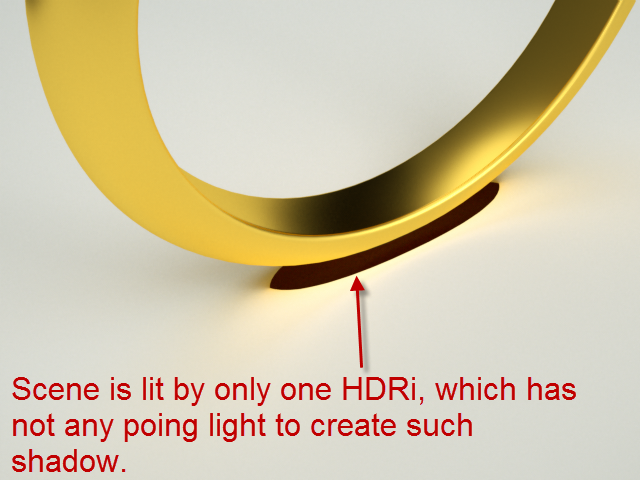

Hi Paul,
There has been a strange shadow coming when objects are touching each other.
I changed to many HDRi and found the same issue.
It behaves like a default light in the scene, although there is not any light other then the HDRi.
Is that because of zero aperture?
Best Regards, Jitendra
Refracty
Posts: 1599
Joined: Wed Dec 01, 2010 6:42 pm
Location: 3D-Visualisierung Köln
try ti decrease rayepsilon to 0.00001
