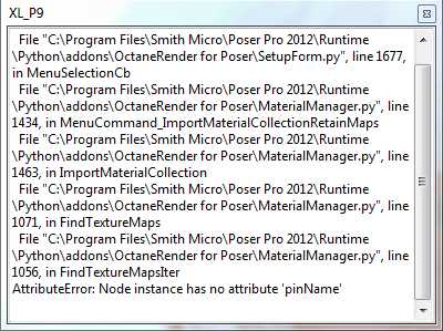

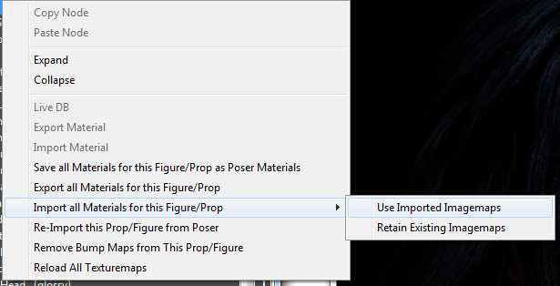

Another wee error message with version 1.20.2.2...
Importing all materials... as shown in the images.

When trying to load "Import all materials for this Figure/Retain existing Imagemaps, I get this error:
Traceback (most recent call last):
File "C:\Program Files\Smith Micro\Poser Pro 2012\Runtime\Python\addons\OctaneRender for Poser\SetupForm.py", line 1677, in MenuSelectionCb
File "C:\Program Files\Smith Micro\Poser Pro 2012\Runtime\Python\addons\OctaneRender for Poser\MaterialManager.py", line 1434, in MenuCommand_ImportMaterialCollectionRetainMaps
File "C:\Program Files\Smith Micro\Poser Pro 2012\Runtime\Python\addons\OctaneRender for Poser\MaterialManager.py", line 1463, in ImportMaterialCollection
File "C:\Program Files\Smith Micro\Poser Pro 2012\Runtime\Python\addons\OctaneRender for Poser\MaterialManager.py", line 1071, in FindTextureMaps
File "C:\Program Files\Smith Micro\Poser Pro 2012\Runtime\Python\addons\OctaneRender for Poser\MaterialManager.py", line 1056, in FindTextureMapsIter
AttributeError: Node instance has no attribute 'pinName'

face_off
Posts: 15830
Location: Adelaide, Australia
I have updated the installers at the top of this thread with
1.20.2.3
- Fixed exception raised when Importing -> Retaining Texturemaps
- Re-write the Compress Texture Maps script to improve it's function, and store the resulting files in the Poser Preferences folder rather than the Poser Temp folder.
Paul
