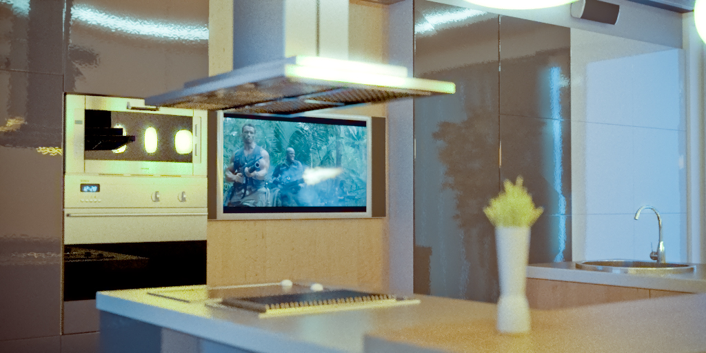

Here is a first render :

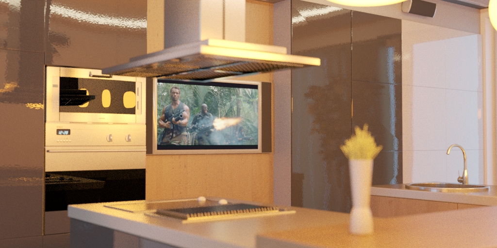

And here is the result after I combine 4 renders at 1000 samples, 3 minutes each - 12 minute render time:

Done in Octane Render 2.3 v4
PS: this image have 8 light sources + daylight
PS2: there is no noise reduction here.. no post, just blending...

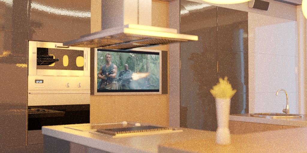

Here is the same with 3 minutes post in PS:
