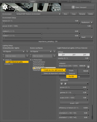

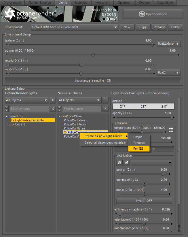

some news ahead: completing the rewrite did also allow to add some features more easily; amongst others there will be a "lighting setup" area in the lights tab:
in general this works like the materials tab, but listing octane materials configured as light sources only (such having an emission node). means you will be able to find and edit light sources pretty quick. linking by drag & drop (or context menu) works also of course, allowing to apply existing light sources to other objects fast.
in addition the node widget (aka node inspector) on the right shows a simplified version of the active material node, only presenting "useful" parameters (in general this is diffuse color and opacity of the base material and of course all the parameters of the emission pin).
a new "create as" menu option (shown) allows to quickly set up any scene object as emitter (this one is also available in the materials tab, in addition to the other "create as" options).
"simple" is a pre-set diffuse material with a blackbody emitter, "textured" is about the same, only using a texture emission with a pre-set (empty) image pin, and "for ies" is again a blackbody emitter with a pre-set (empty) floatimage distribution pin for an ies texture. means you can set up anything from here without the need to open the nge.
ps: an option to insert pre-made light objects into the scene will follow a little later, since it needs (of course) some time to prepare all the geometries & settings...
