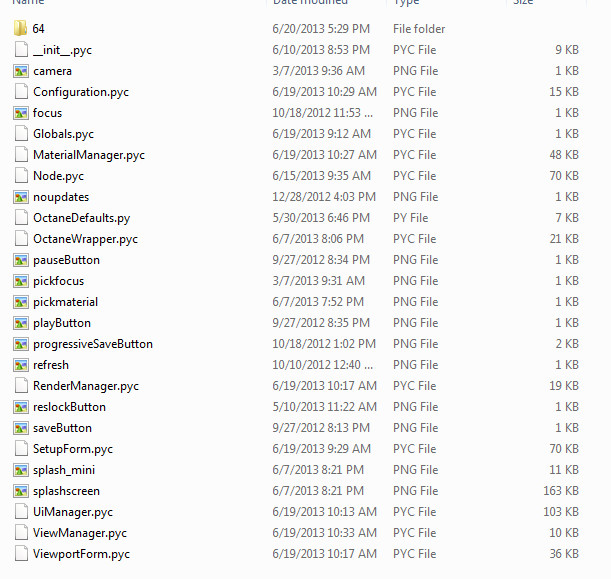

Here are 2 screenshots. One of the addons folder, and another inside the octane folder.
Poser 2014 resides just under Poser 2012 in the Poser folder in programs. Again, no Octane.dat file in the Poser 2014 folder.

Very strange. The file __init__.pyc will either add the OctaneRender menu item to the Poser menu, or give a warning. If it is doing neither (and not producing an octaneplugin.log file), then Poser is not running it. That means either the Poser 2014 exe (PoserPro.exe) that you are running is not in the parent directory of where the plugin is installer, OR the Poser 2014 installation has not run correctly.
May I suggest....
1) Re-install Poser Pro 2014 (install into the default C:\Program Files\Smith Micro\Poser Pro 2014 Location)
2) Re-install the latest version of the plugin.
If that works, THEN install SR1 for Poser Pro 2014.
Paul
octane.dat will be in the '64' folder.

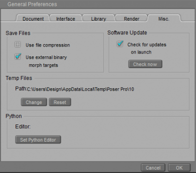

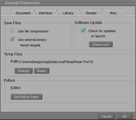

there is no 64 folder in this location, just 9 & 10
