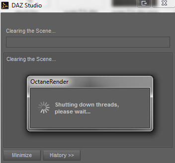

can you please also check if turning auto mats / live geometry off helps to load something?larsmidnatt wrote:shutting down threads, please wait is all i see
This happens when I try to load an old .daz file, so I thought it was that. I restart DS and decided to close it to get the 4.6 update and I get the same message eventhouh nothing has been done at all yet.
Will see if 4.6 update fixes it.
btw; there are background threads running at the moment the ui gets visible, since there is already an active scene (even if empty) and misc. cameras; when a scene is loaded ds requests a clear (same as clicking "new"), which needs to shut all that down, resets octane, and so on.
can you please also check if the ds log shows something like "error clearing scene" after that happened?
thanks!

ive seen it sit at clearing the scene for several minutes with no updates. same as with the 4.6 update
i have tried loading a variety of scenes and this happens every time. Each time I force quit out of DS and on fresh launch load an existing scene. This happens for scenes that have octane data as well as ones that don't.

You'll need to chop Daz Studio off at the knees (kill the process in Task Manager). When you restart Daz Studio, before you load a scene, uncheck one (or both) of the auto update options in the preferences tab (one is for geometry the other materials). That fixed the trick for me.larsmidnatt wrote:ive seen it sit at clearing the scene for several minutes with no updates. same as with the 4.6 update

ok, it won't go away since there did already something happen; means the plugin progress was crashing, but ds catches all crashes on clear/load/save, so the only result is, that progress stops wherever it currently is; do you start up with a blank scene or with some default scene?larsmidnatt wrote:ive seen it sit at clearing the scene for several minutes with no updates. same as with the 4.6 update

i always start with blank scene.
