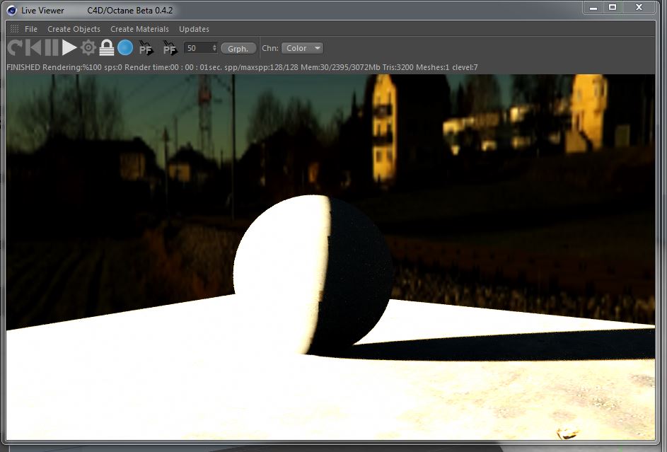

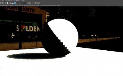

But when I start to add an texture environment, it always looks
like this:
When I change gamma to correct the look of the models, the
background hdri gets black and vice versa.
thanks
Mike

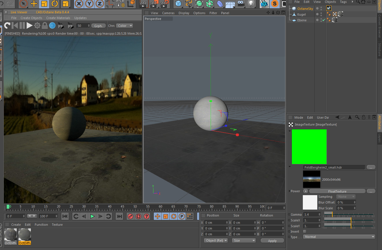

thanks
Mike
little tweak on hdr gamma
