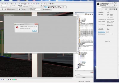

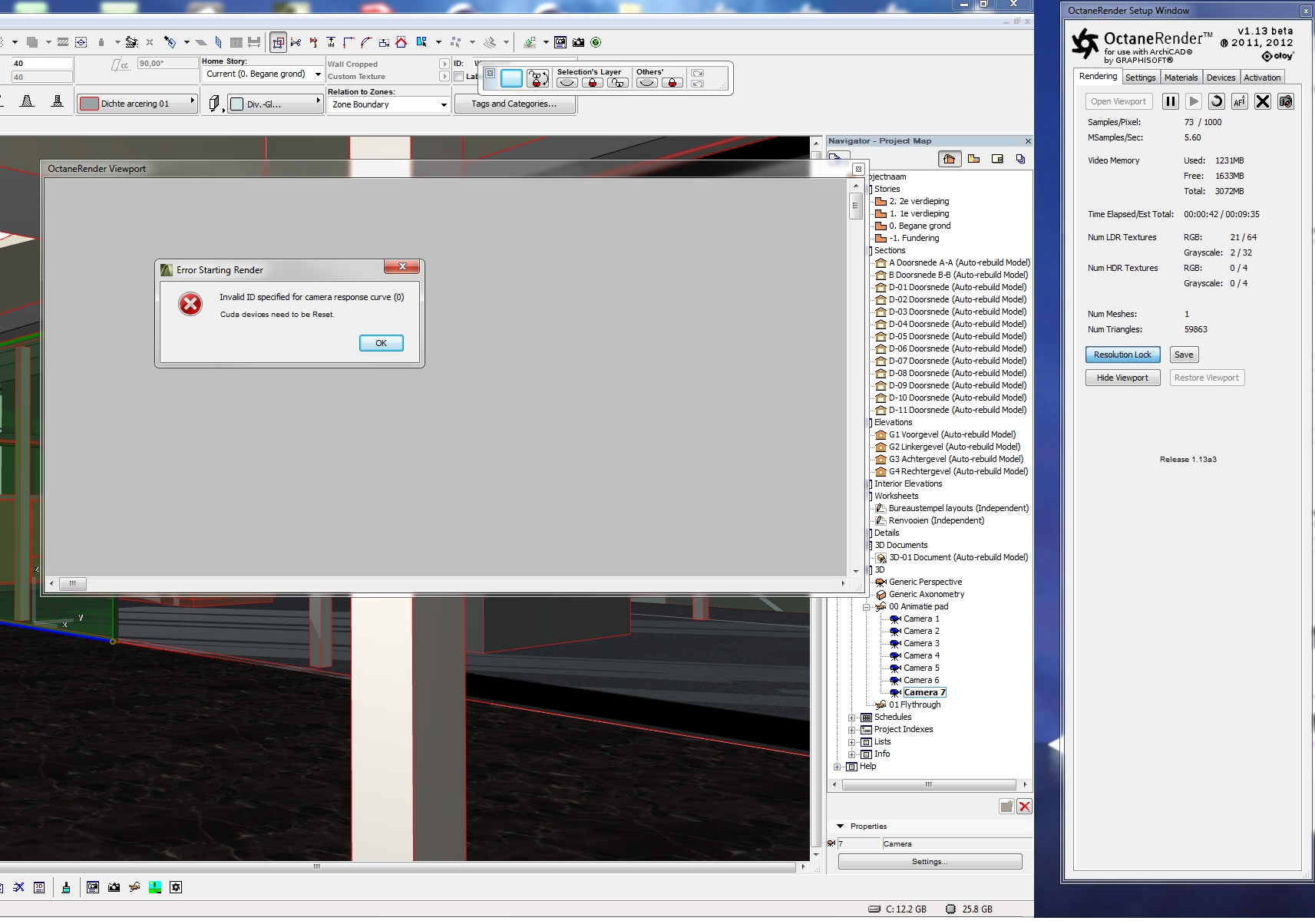

I am getting this and I don't know the specific thing to replicate.
It started after chosing a different imager-response but I am not sure if it is the cause.
btw: working with 1.13a3
Clicking the checkboxes for activate GPU in Devices is not or very slowly responding when ticking them.

I get this message when trying to change the material node.
Am I doing something wrong or is something going wrong?
From the errors you are both getting, it looks liek something is amiss in the node system. I will fix this ASAP.
[EDIT: Have found the issue - it is related to increasing the number of material from 1000 to 10000].
Paul
