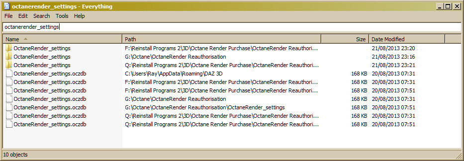

Hi, thanks for trying to sort this out. I really appreciate it. I've attached a screen grab of the search I did. My OS drive is C\:

ok, this reads not all that alarming; settings location is ok, size too. of course the more strange it is what just happens. need to dig into it step by step;
- the settings file shows a "modified" date/time from when i uploaded it, means if you already tried activation again after copying it over, there was nothing written to it (bad).
- pls delete it from the C:\Users\Ray\AppData\Roaming\DAZ 3D folder.
- open ds (with the plugin in place), the plugin should be accessible, but of course not activated. close ds. if you now look into the above folder, you should see a new settings file, with about 9kb size (only a stub which the plugin creates when it starts). copy the default file you got over once again (so it'll again look like in your screenshot).
- if you now open the activation manager directly (OctaneACM.exe from the daz studio application folder, usually under C:\Programs\DAZ 3D\DAZStudio4), ideally by right-clicking it and use "run as administrator", it'll of course have username and password empty. if you enter them, and press "activate" it should say "successfully activated" (this means it could reach the activation server and the credentials were correct).
at this point the "modified" date/time of the settings file should have changed to the current date/time, and if you open the acm again, it should show the username and dots for that password. if this is not the case, something blocks write access to the settings file. unfortunately there are no checks in this version if the credentials were actually written to the settings file.
pls check and make sure that the file is not set to "read only"; the only else thing that comes into my mind is an antivirus program that blocks write access to this file (rather uncommon).
note: you wrote your plugin version is r1.11 from march, 25 - most probably you had updated it to this version http://render.otoy.com/forum/viewtopic.php?f=44&t=33059 right? if you are unsure if the updated version is still in place, you may perform the update once again, prior trying out the above steps.
ps: if everything fails, and we are not able to work out the reason for the problem right now, i can still prepare a settings file which already contains your credentials and pm it to you - so you should be at least able to use the plugin again...
