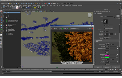

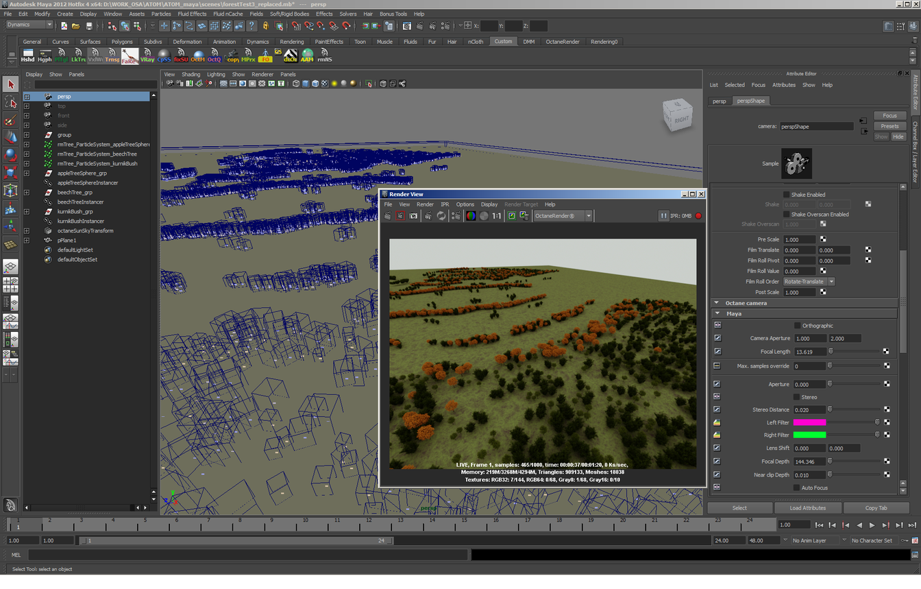

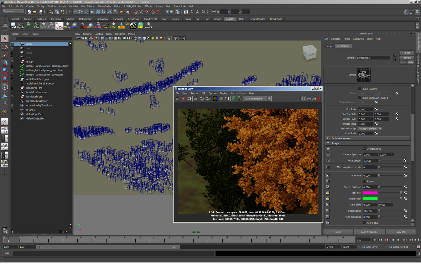

I found some troubles in camera. Ortho camera doesn't match viewport ortho at all. I can't figure out how to change it.
Changing Camera Aperture and Focal Lenght has no effect.
