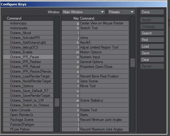

Direwolf wrote:I'm running on 1 GPU at the moment, and it's making LW really sluggish. Adjusting settings/materials become really hard with a sluggish machine. And for the first setup phase I really don't need more then 20-50 samples.
BTW, you can also map the "Octane_IPR_Pause" command to a hot key to pause/unpause without the need of go to the IPR window with your mouse.
