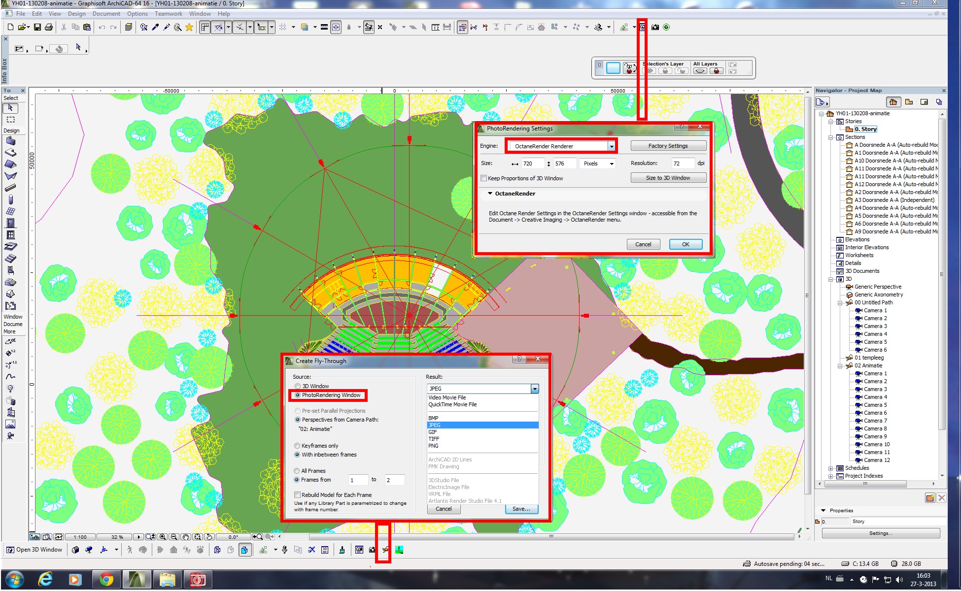

Will it be possible to get a animation out of Archicad with the saved viewport picture?
In ArchiCad you can "play" the animation in the 3D-Window -with OpenGL turned on it runs nearly in realtime - so if Octane could save its picture
(hold back ArchiCad from jumping to the next frame till the rendering is finished) and repeat that with every frame - that would be perfect !
I can do the process manually frame by frame, so it theoretically only needs to be automated...
Thanks in advance & greetings,
A
It is much easier to create an animation.. just create a flythrough and render it with the plugin.
Hopefully does the printscreen explain enough.
greetz, Jeroen

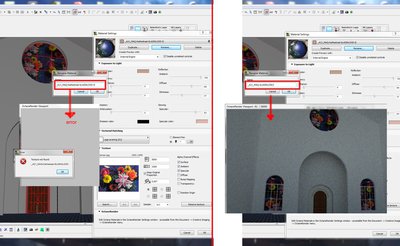

face_off wrote:
When transfering the geometry from Archicad to Octane I get the error "Texture not Found" with the given name of the Archicad-Material.
The problem: this material has no texture. OK, then I assign a texture (via the Archicad material editor) but the error persists !
By removing the material this error disappears but this is of course not a real solution...
Are there any restricions for textures/filenames/... ?
(In Archicad all needed libraries are loaded and nothing missing of course)

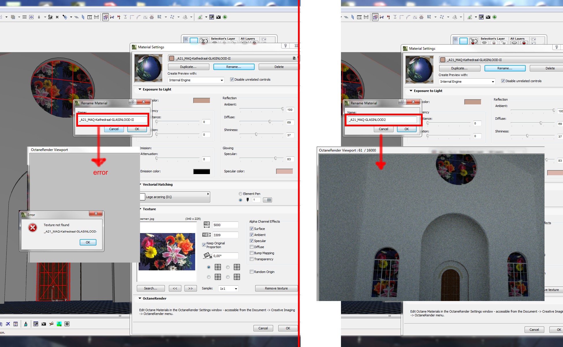

I had the same problem with error "texture not found".
while changing the name AC even crashed,
but I have found where the problem might be: I changed the name by making it shorter and it loaded :lol:
After making the material name longer again (_A21_MAQ-GLASINLOOD2-testingtestingtesting) I got the error again,
so.. maybe the material names have a maximum length?
greetings, Jeroen
As Jeroen said, do this by creating a fly-thru. Add two camera paths (View->Navigation Extras->Path Camera Into Path). Then set the photorender to Octane (Document->Creative Imaging->Photorender Settings->Engine=OctaneRender). Start the Octane plugin. For "nearly realtime", set the rendertarget->kernel->maxsamples to something like 20. Then animation via Creative Imaging->Create Flythru->Photorendering.
I think you are right. I will investigate and post a patch to rectify this.

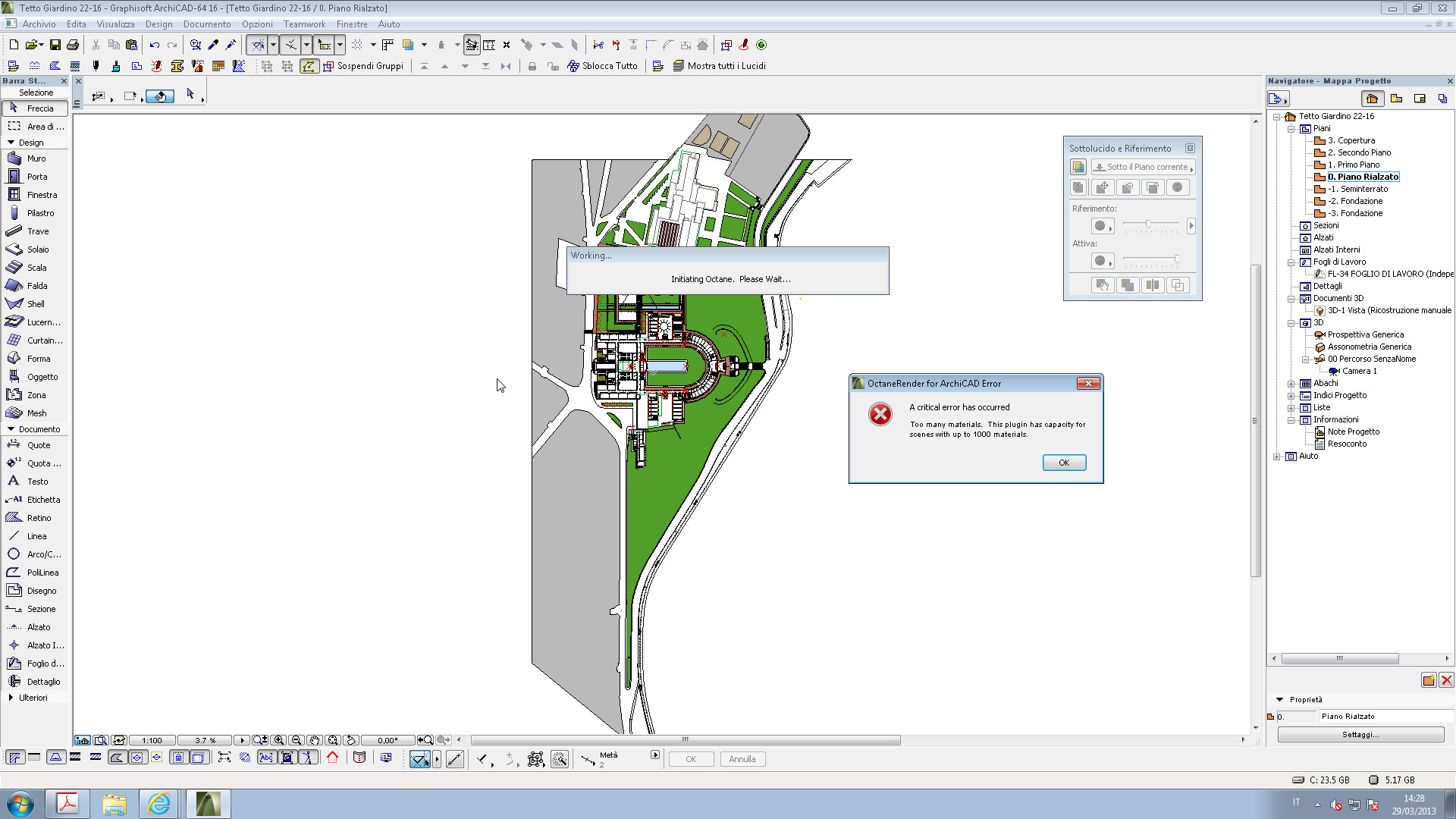

Once opened my project file and start the plugin from Document> Creative
Imaging> OctaneRender, you receive the following message on the screen.....
A critical error has occured
Too many materials. This plugin has capacity for
scenes with up to 1000 materials.
Which means, I do not think that there are more than 1000 materials in the file.
someone can give me a solution...........
thanks
face_off
Posts: 15830
Location: Adelaide, Australia
Hi tlux. I am away over Easter but when I return I will post a version with a higher material capacity. From memory the 1.02 version will not have this limit (but make sure material names are less than 50 chars).
