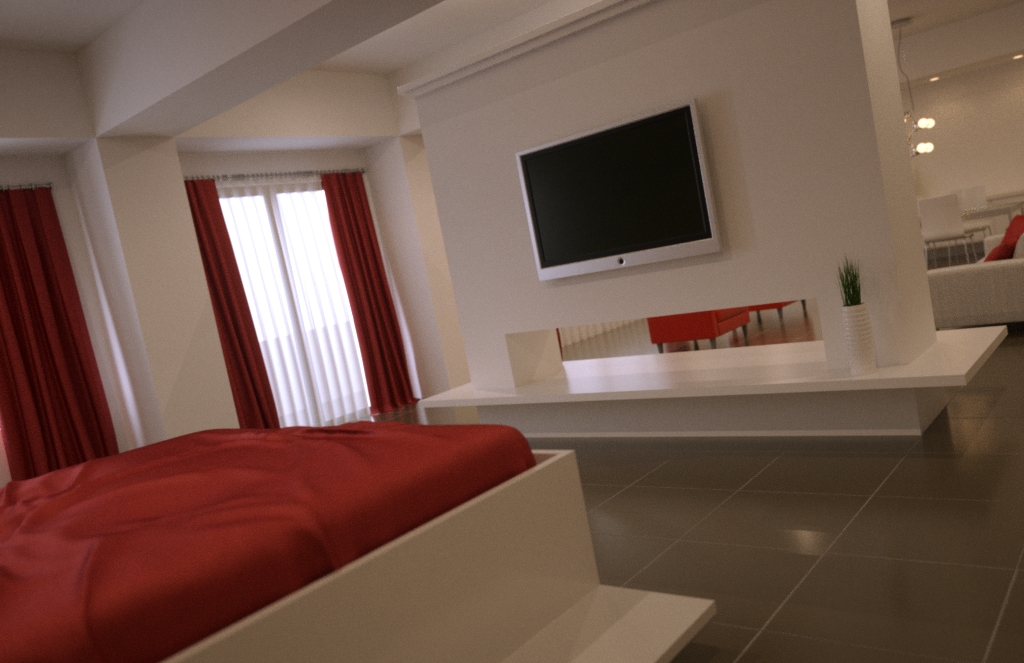

I changed the kernel to PMC and the sampling rate to 6000 just to test it. It seems as if I'm starting to see a huge improvement already. I just have to wait to see how long it takes me to get something near-noiseless. Thanks for your help!

Here is the updated image rendered via PMC with 10000 samples with 28 min rendertime at 1024x663. I replaced all the ceiling lights with blackbody emitters and actually have a cleaner result in quality and noise. Huge improvement, but still not amazing time-wise. I feel this is somewhat workable now and can definitely add a denoiser in post, but it's higher resolutions I am more worried about. Do I have any options in regards to doing further optimization or is Octane not yet completely interior friendly?

buy a system with 4 gpu, this is the only way
Imagine to render this scene with vray and bruteforce set to 24 - 3
also set dmc sample set to 1 - 16
also noise threshold set to 0.005
your system will render for 8 hours, more or less.
I don't see any noise in your render, it's ok.
Btw, every photographer that shoots interiors always use a lot of tricks, flashes, lamps, banks, post-production, etc.
The most powerful ccd sensor generates grain in low light conditions (Hasselblad).
quad Titan Kepler 6GB + quad Titan X Pascal 12GB + quad GTX1080 8GB + dual GTX1080Ti 11GB

My motherboard supports 4 GPUs but heat is something I'm worried about. I would have to spend some money and resort to liquid cooling unfortunately. I tried using 3 cards in there already with their stock coolers and the heat was just way too high, even with my well ventilated case. :( I was extremely scared for my hardware.
