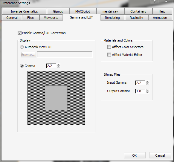

yeah all right ?!bicket wrote: Did you correctly configure the Gamma/LUT in 3dsMax ?
I mean : enable it, set gamma to 2.2, check Affect color selectors.

I read another post earlier and set upbicket wrote: Did you correctly configure the Gamma/LUT in 3dsMax ?
but can be wrong of me

I just think your color will be more accurate if you check "Color Selector".Vanya wrote:yeah all right ?!bicket wrote: Did you correctly configure the Gamma/LUT in 3dsMax ?
Thank you bicket so much better .. but I can not find the standard fstop+ISO. You do not know?bicket wrote:I just think your color will be more accurate if you check "Color Selector".Vanya wrote:yeah all right ?!bicket wrote: Did you correctly configure the Gamma/LUT in 3dsMax ?
I mean, the standard fstop+ISO, to see the true colors.
