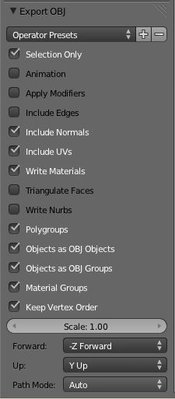

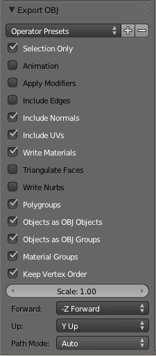

For blender, I experimented some problems, particulary with octane-poser plugin as i already said to you, Paul, but with the following export-settings ( see attached) for blender seems to avoid them...
