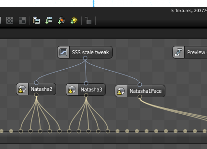

I have one question: I did not find a way to save the converted Octane scene. Is this done automatically in some hidden folder?
Reason I'm asking is that once the setup of the scene is complete, and you're only tweaking lighting / materials, it would be no longer
required to fire up Poser for that. Another possible reason would be some extension of Octane which is not yet mirrored in the plugin.
Apart from that, it would be sufficient to work just in Poser.
Hi Michael. The converted Octane is saved with the Poser scene when you File -> Save. Then all the settings and materials are reloaded when you File -> Load. You need to have the Poser scene open for the Octane scene you are rendering. The Octane scene is not saved in OCS format (although this will potentially be possible in a future release), however there should be no need for loaded the scene into Octane Standalone, as all the features from Standalone are in the Poser plugin. The next release of the plugin will include the Instancing implementation in the current version of Octane Standalone.
Hi Paul,
thanks a lot for your fast reply. Yes, all my material modifications are stored and reloaded when I save / reload the Poser scene. I think, the ability to save to .ocs would be a very important feature, during finetuning. In Octane, I use shared parameters to allow fast and uniform setting of parameters, while the material structure I can work on in the Poser plugin is a tree, very much like the Carrara material system. I attach a screenshot to explain. For a change of the "SSS scale tweak" parameter in a tree structure, I would need to make the change in 9 materials separately.
(I am aware that the moment I use the .ocs format, the link to the Poser scene will be broken. But as I said, that would be only done for final finetuning.)
face_off wrote:
One more thing I cannot figure out how to do is how to modify materials
Go to the Materials tab in the plugin and click a node, then at the bottom of the window you can change the node type. Rightclick a material to save to disk. The save format the same as the Standalone material macros.
I need some more help with the material save / reload. What I did was to select the "Export Material" choice from the right-click context menu. It offered to save into files with extension .poe, and the file contents is binary data. In Octane, when I import a material macro, it wants a file with extension .ocm (which is in XML format). Maybe I picked the wrong choice.
Best regards,
Michael
P.S.: I am very happy with the workflow of the plugin. This is a very good design! It is very convenient to change some textures in Poser via pz2 or .mc6 loading, then to right-click the figure, reimport the materials from poser for that specific figure, then to reload the figure's Octane shader, keeping the texture maps. I could never before test different texture maps so fast.
Hi Michael
Your workflow in Octane Standalone is almost identical to what mine was - so I understand where you are going from. The original plan with the plugin was for shared nodes, however that introduced a number of issues that meant copy/paste retaining texturemaps (and some of the other functions) could not be implemented. So the idea now is rather than have a shared parameter, simply copy and paste the material to the other materials that use that parameter. If doing this 9 times is an issue (and I think it would be!), then I could add a rightclick option to paste the current material to all SKIN materials (retaining the original texturemaps). Would that resolve your issue?
Export to OCS was part of the original functionality of the plugin, however I removed for a couple of reasons (primarily it did not work flawlessly). Ultimately, there shouldn't be any reason to export to Octane Standalone. Everything that can be done in Standalone can be done in the plugin. Any tweaks you are making in Standalone should be able to be made in the plugin faster and more efficiently - that's the goal anyway :-)
There is not currently a facility to import/export ocm. If there is a large number of requests for it, then it could be done, but I'm not sure what it achieves. The only possible reason would be to use that material in Octane Standalone - see above for my opinion on that :-) Plus, people will manually tweak the ocm and then redo into the plugin and cause node integrity issues. If you need to tweak a material, load it, change it in the tree, save it.
Thanks for the feedback. A lot of thought went into the design - since it needed to cater for very experienced Octane users, and also relative novices.
I am currently working with the beta team on release 1.1, which contains the Instancing implementation, plus a range of other neat features. So it's good to hear suggestions on the workflow from people like yourself.
Paul
