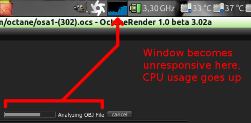

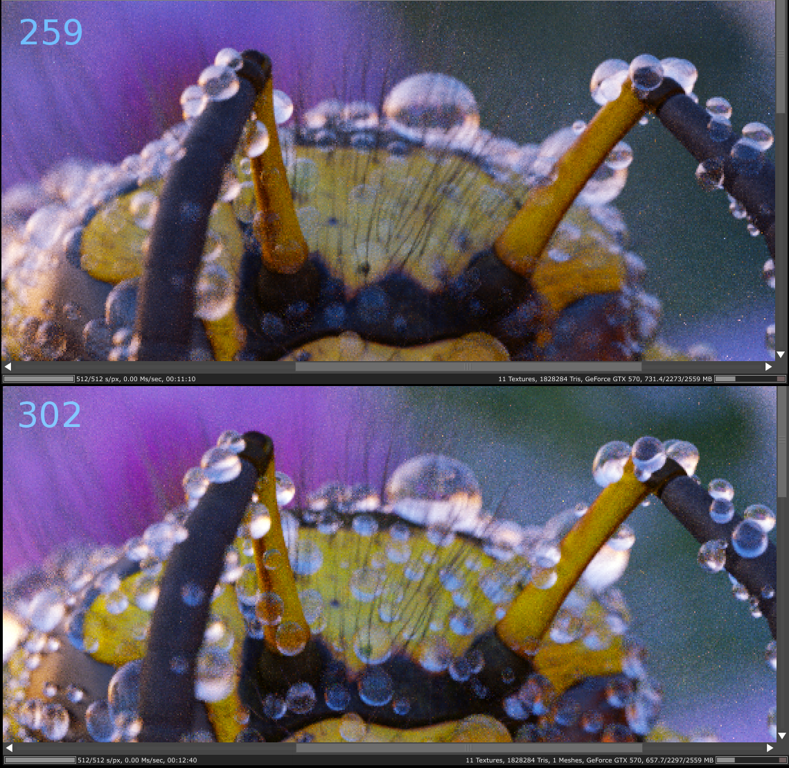

I did another comparison between 259 and 302 (Fermi card, Linux). I tried to compare "quality", but it's really hard to evaluate it, mainly because of the random noise seed. They kinda look the same, except in 302 there is different lighting, though the setting are the same in both cases. Have anything changed around HDRI lighting (or maybe it's the specular material?)? (notice also 302 eats less ram - same scene, no instances used)
PMC
259 -> 512 samples in 11:10
302 -> 512 samples in 12:40 (12.3% slower)
There is a huge difference in loading times, though:
259 -> 0:41
302 -> 2:46 !!!
The loading process freezes and resumes several times during "analyzing obj / parsing vertex" phase. I'm using Linux Mint with the old Gnome 2 desktop environment. Could this be related to the new way the info is showed in the window itself and not with popups anymore?

The loading time issue got fixed today and the fix will become available with the next release. (We were basically redrawing the status bar a gazillion times...)

wow, interesting test matej ;)
the bubbles in the 3.02 version are extremely more pleasant for me, there is a completely different way to calculate the reflections but also the refraction :o

bepeg4d wrote:the bubbles in the 3.02 version are extremely more pleasant for me, there is a completely different way to calculate the reflections but also the refraction :o
Yeah, I agree, the water droplets in 302 look much more appealing. The material is a mix (mostly specular) between default specular & glossy, with both having lowered opacity too.
I think a ~10% speed drop for PMC is acceptable for all the new goodies in 302. Too bad DL shows a higher speed drop, something around 20% for the tests I did...
Why don't you use just one specular material for the droplets?
Regarding the speed drop: How does it compare to 3.01? 2.59 doesn't support instances which is probably the main reason why it's faster.
