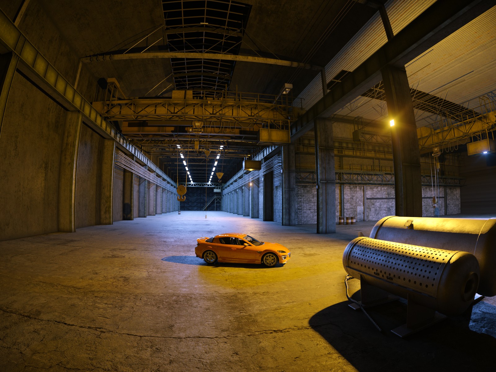

The render posted by karba in this thread is missing a lot of light and thus bounces that should spill into the space from the strip of skylights above. There should be some sunlight hitting the floor beyond and even the hood of the car to make the render look more believable. not only the little bit we see on the floor on right

Evermotion .I. //// 20 min ....... LOL
nice work KaRBa
