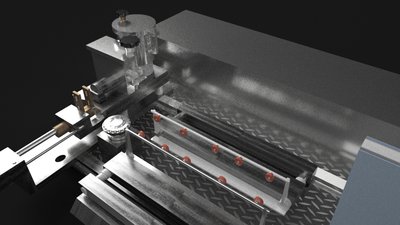

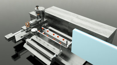

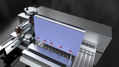

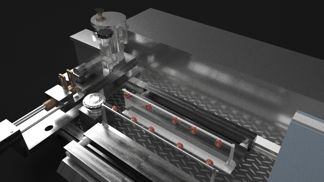

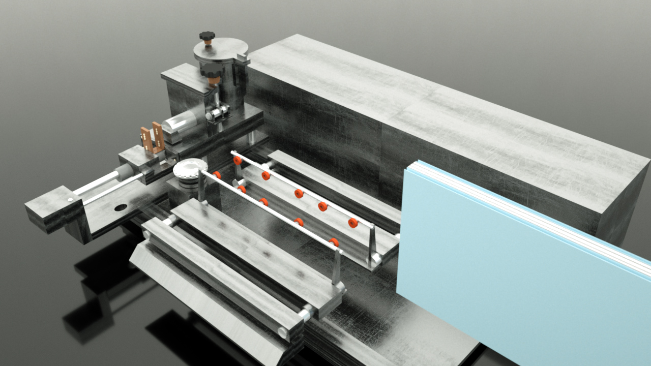

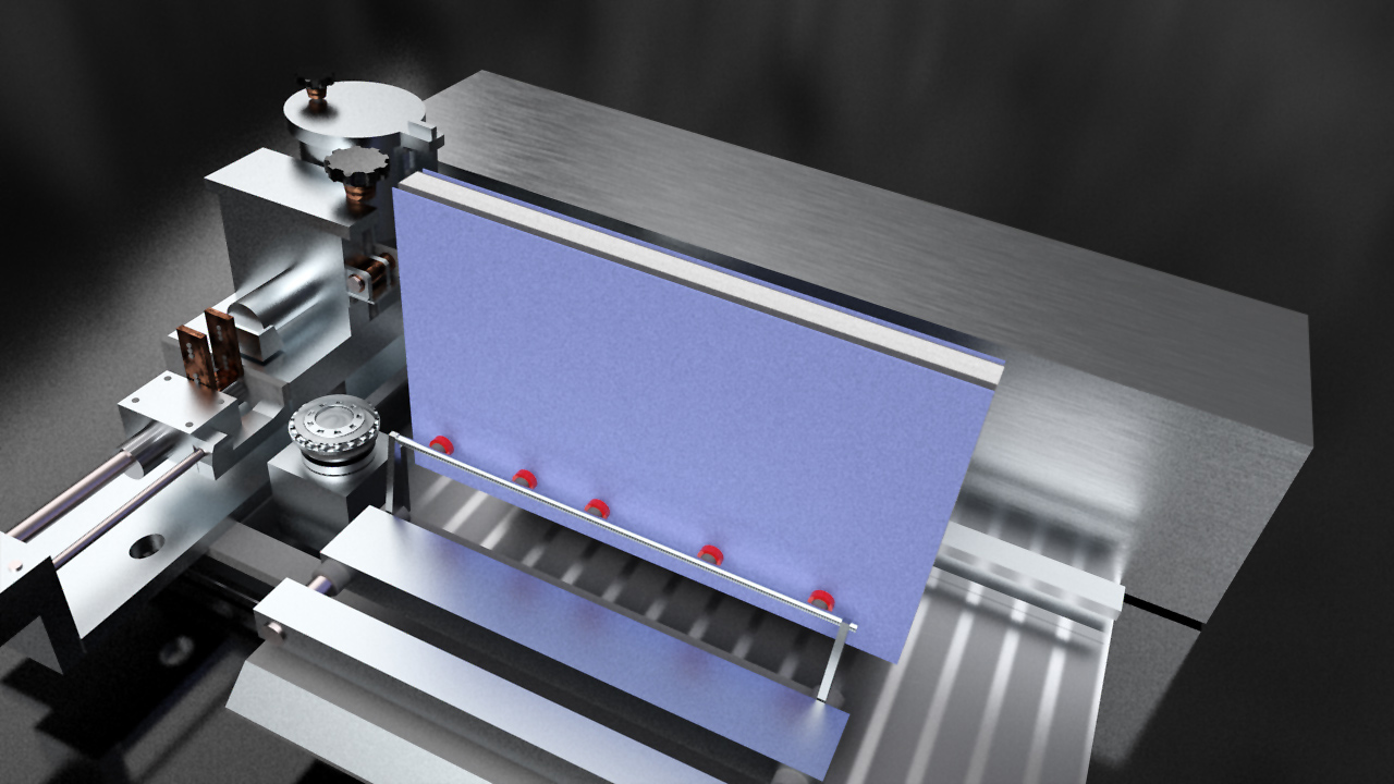

It's easy! Very thanks brother... but this Octanerender for 3Dsmax is very very slow respect the standalone version! I use the standalone in C4D and has more speed and quality rendering! the C4D version is outstanding..not the same for this 3DSmax version.. I'm not happy of this.. the No there isn't a plugin for 3DSmax 2013 for export to standalone?
This is Maxlive Render - 4 minutes - 1280x720
This is OctaneRender for 3DSmax 2013 version - 3minutes - 1280x720
This is C4D and plugin export to Standalone OctaneRender version - 3minutes - 1280x720 - 2000 samples
suvakas
Posts: 503
Joined: Sun Jun 12, 2011 10:26 am
areafilm wrote:It's easy! Very thanks brother... but this Octanerender for 3Dsmax is very very slow respect the standalone version! I use the standalone in C4D and has more speed and quality rendering! the C4D version is outstanding..not the same for this 3DSmax version.. I'm not happy of this.. the No there isn't a plugin for 3DSmax 2013 for export to standalone?
Are you using the same version of standalone as your Max plugin?
It seems that older versions were faster because of no instances support.
