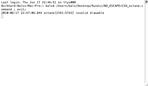

Ok, here are the results:
When starting NO_ESCAPE...._new.command with a double click octane starts and imidiately shut down with : invalid drawable ( see attached )
The .ocs file was build.
After taking a double click on the NO-ESCAPE.... .command all works fine. Octane opens, the render works and it seems no problems!
Same with the other NO-ESCAPE commands except the ORIGINAL ones. Same error here as before: no such file or directory ...or... Command not found
