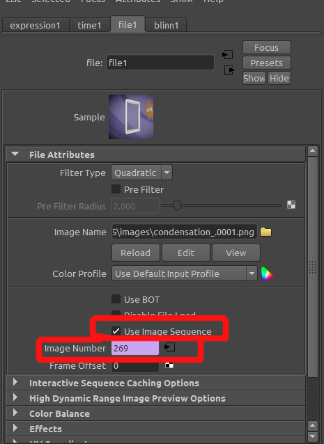

can the plugin suport images sequece?
It is important to animation!!

renmaxhb wrote:can the plugin suport images sequece?
I don't understand, what you mean talking "suport images sequece"?..
I was going to ask you about this too.
On the file node you can check off 'Use Image Sequence' for animated textures.
