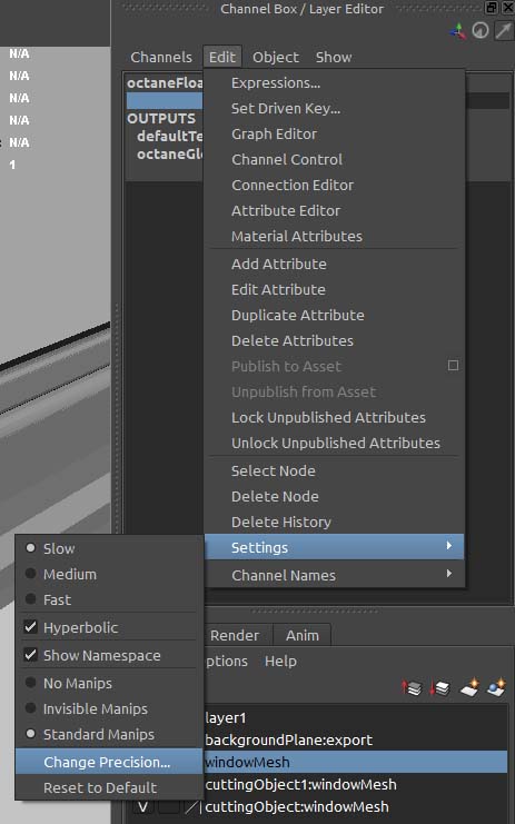

So as far as I know in Maya, without coding, you can only get more precision for tweaking shaders if you use the channel box.
In the channel box's menu, under edit >settings> precision you can change it to something larger.
You only need to do that once.
Then if you're going to use the slider, set it to slow and check hyperbolic.
The thing with the roughness attributes in the plugin is that they're not keyable attributes so they won't show up in the channel box (or channel control) so you have to add an octaneFloatTexture to the roughness first and fine tune that value in the channel box.
Hope that makes sense.
JimStar: Hey, is there a way to code the plugin so that we can get more precision in the attribute editor for the roughness or a way so that the attribute is visible in the channel box / channel control?
octaneFloatTexture piped into the octaneGlossyMaterial's roughness
Change Precision
Change Precision
Change Precision.jpg (31.24 KiB) Viewed 3924 times
Channel box settings
