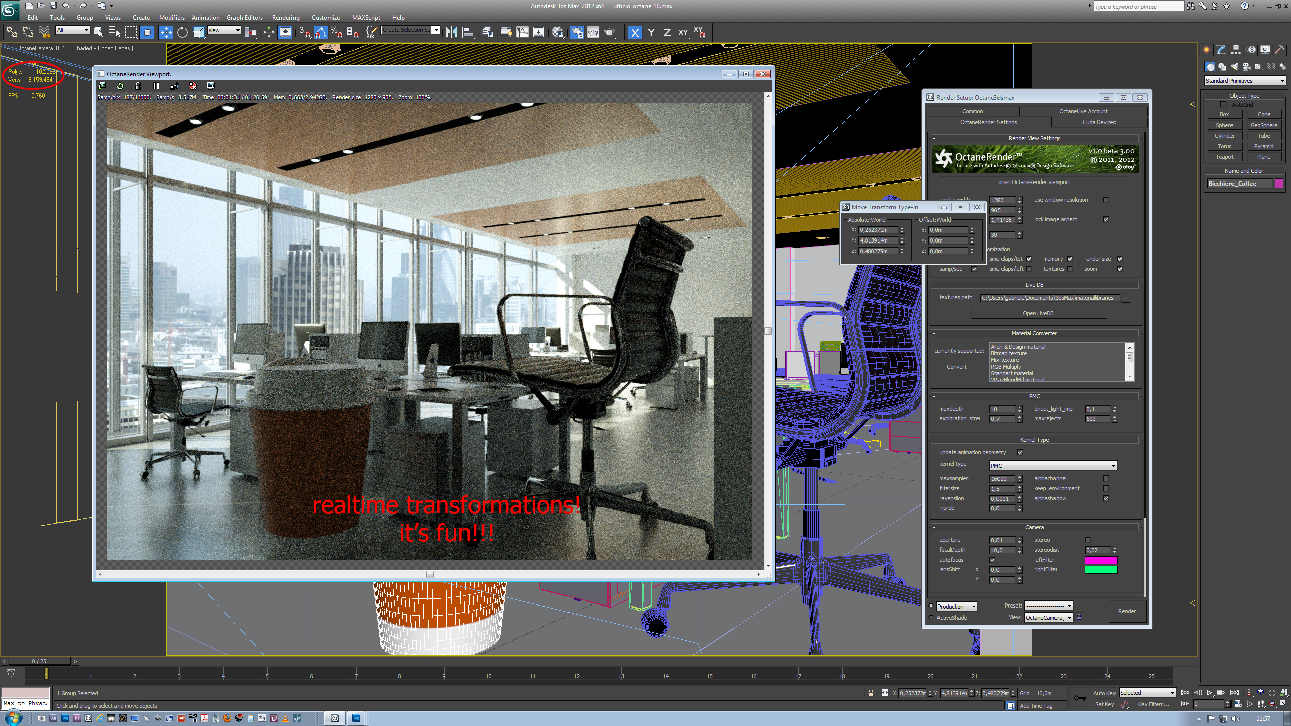

wow..now it's possible to clone objects in realtime...hide-unhide
unfortunately switching ies texture is not in realtime...

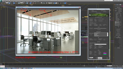

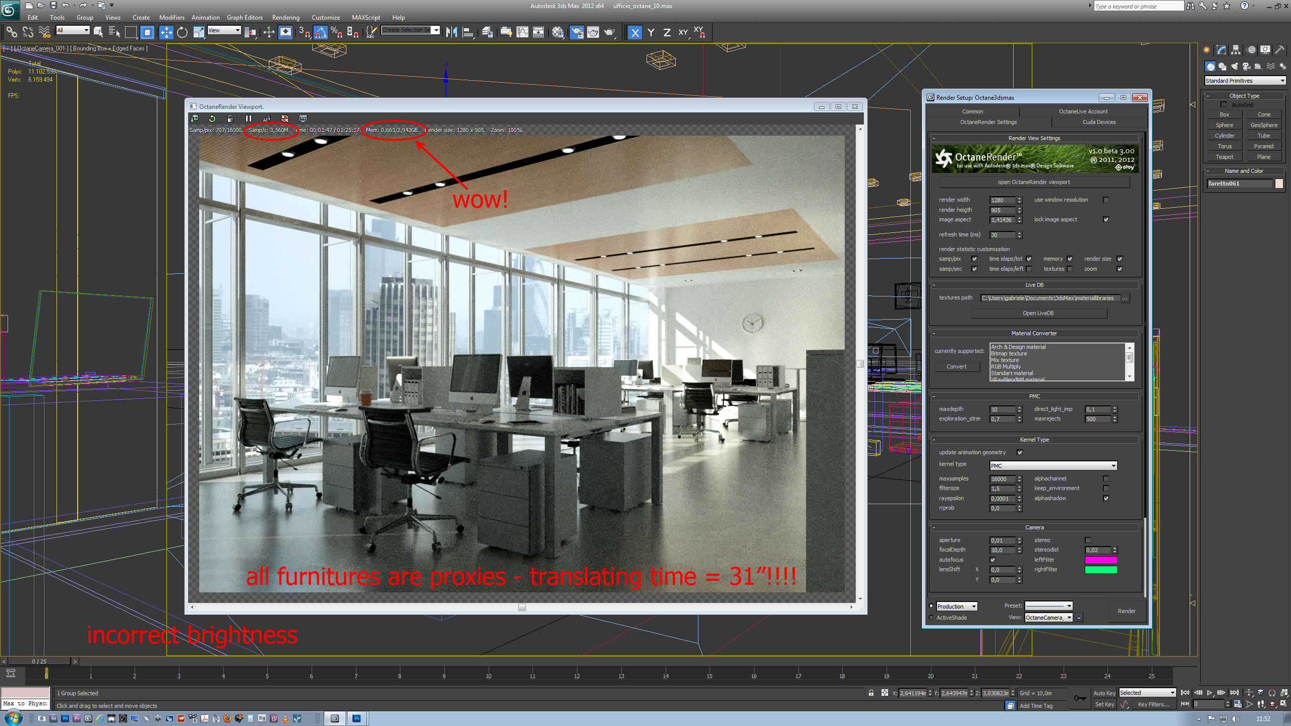

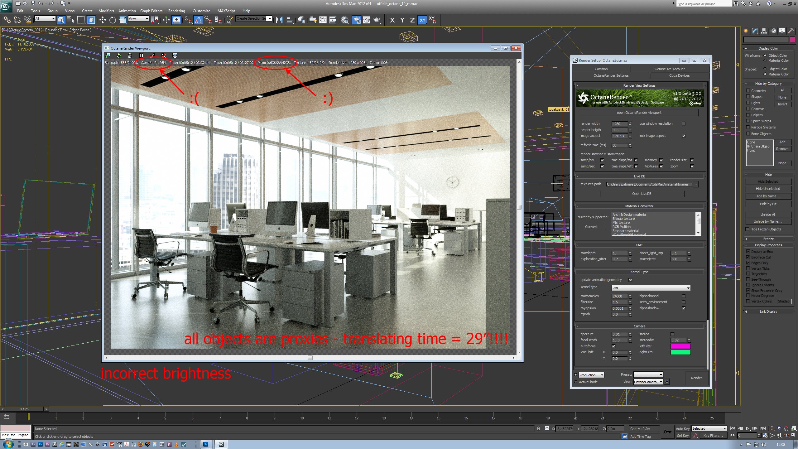

issue#1 (during a realtime render) when adding movable proxy variable to the object it is cloned, we get two copies of the same object.
issue#2 with rectangular light: emits light from the back, sphere light project its geometry shadows.
issue#3 invisible lights are visible in reflections
quad Titan Kepler 6GB + quad Titan X Pascal 12GB + quad GTX1080 8GB + dual GTX1080Ti 11GB

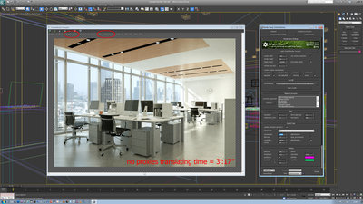

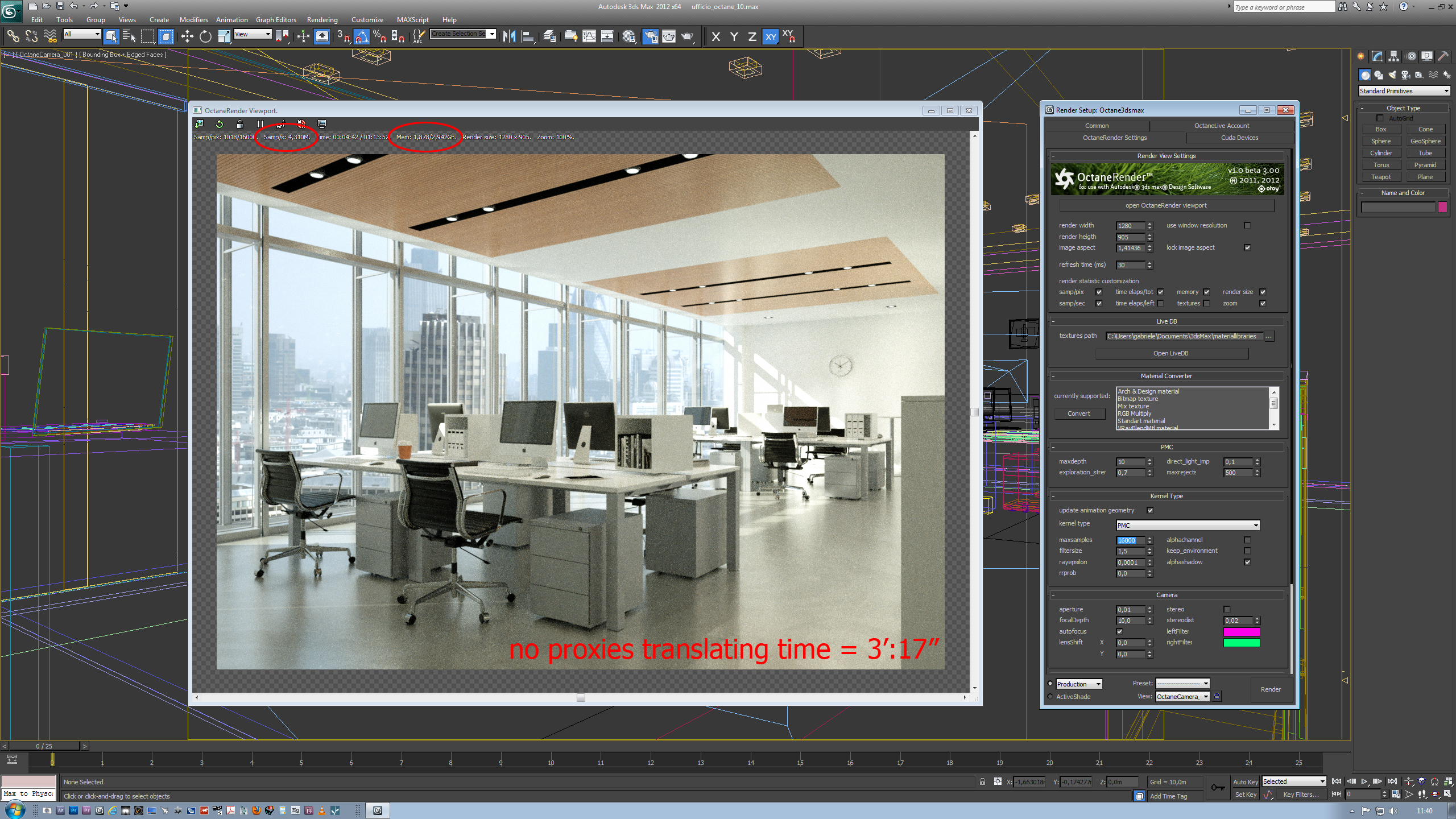

@acc24ex
yes, enabling instances for all instanced geometries the speed decrease of 50% (in my test)
I think that the code must be optimized yet but has great potential.

that is a bit crappy, still it's awesome working with real time transforms - also UVW mapping works in realtime - this is great, I always tend to tweak uvws when I notice somethings wrong in the render window and pressing reload 10 times until i get it right, this eliminates a lot of update render geometry button presses..
also real time light placement - the world of realtime rendering just got a bit more realtime

Karba
Posts: 2300
gabrielefx wrote:@acc24ex
That is why I added this option.
It is not good idea to use proxy everywhere.
Fox example, you should not use building walls, floor and ceiling as proxy.
