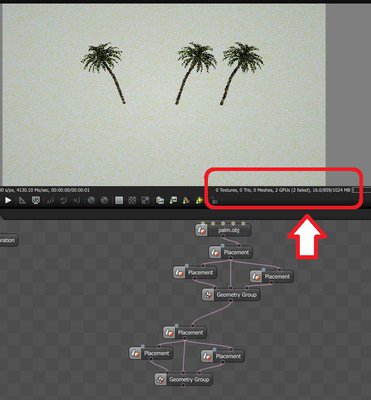

Interesting thing happened to me today, that both GPU failed during a instancing setup as shown below. The only way to get it going again was to exit octane.
UPDATE:
Apparently when I started the projet the large building that I had in the scene originally must have beeen using memory even after it was deleted from the scene, because this time I did the same thing with the building and the trees and just started new scene and it continued.

I've noticed "crashing cards" too, when dumping old scenes or meshes and replacing with new ones, but only when they were large compared to the VRAM available. Sometimes a system reboot was the only remedy.
