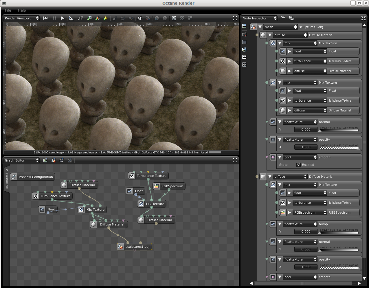

Great work, feels much more stable and like the materials... from time to time there are nodes that still wont detach their connecton (they snap back) and if you try several times to detach them, octan will eventually and suddenly close..

efioramonti wrote:Great work, feels much more stable and like the materials... from time to time there are nodes that still wont detach their connecton (they snap back) and if you try several times to detach them, octan will eventually and suddenly close..
can you give us a procedure to reproduce ?

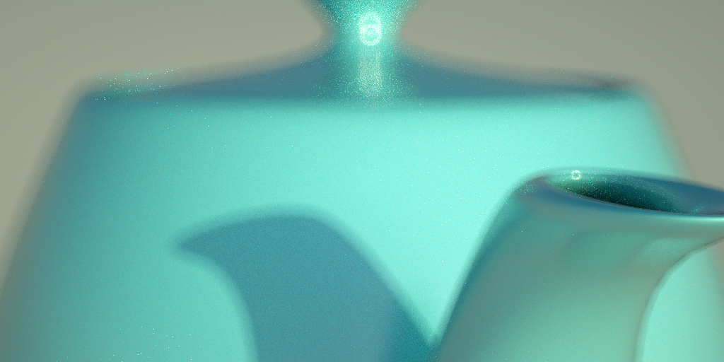

the dof looks ring-shaped, see first img attached.

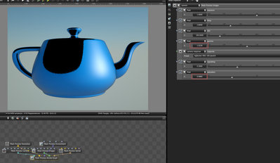

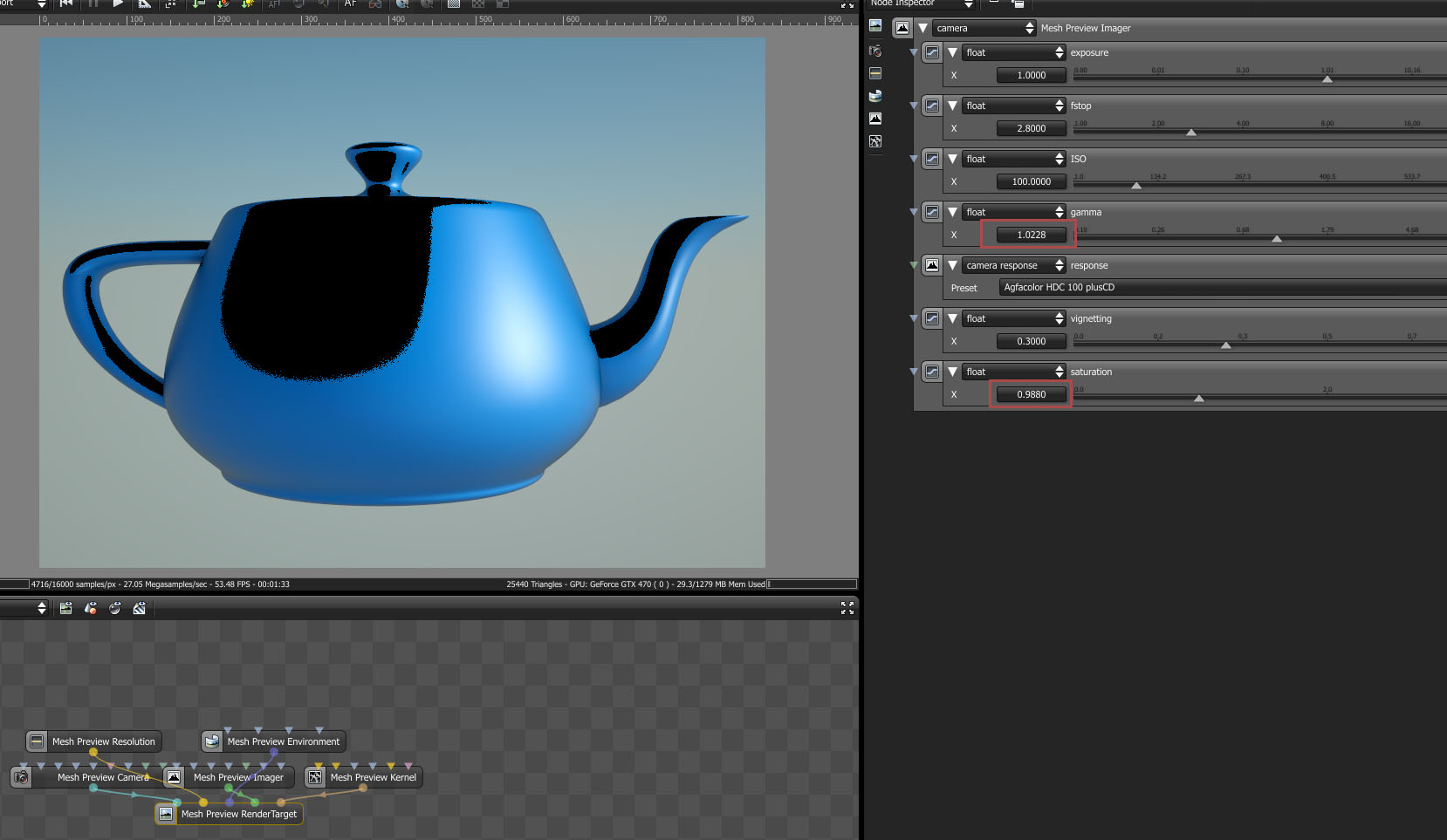

(This happened in RC2 as well): when the gamma and saturation of the 'Mesh Preview Imager" are BOTH not equal to 1, near-blue colors go black (and to a lesser degree green), like nasty looking black pixels. See second and third images.
ring-shaped depth of field
when either gamma or saturation have a value of 1, everything's ok
when gamma and saturation have both values other than 1, blackness instead of blue

a picture sais more than 1000 words... was easy to reproduce... tried do detach second diffuse material from object, this time i succeded but could't attach it again for 4 tries, than it attached and when I tried to detach again it snapped back, and the second time i tried to detach octan closed without a warning.
Have seen also that reopening with the same scene file saved before it closed, I had problems with the camera view, as if it went back to it's standard view and had to adjust the camera view again. I've seen this espaecially happening with .obj models exportet from Sculptris even if imported in Blender and reexported into Octane through the blender script.
that's all for now... good night everybody...
