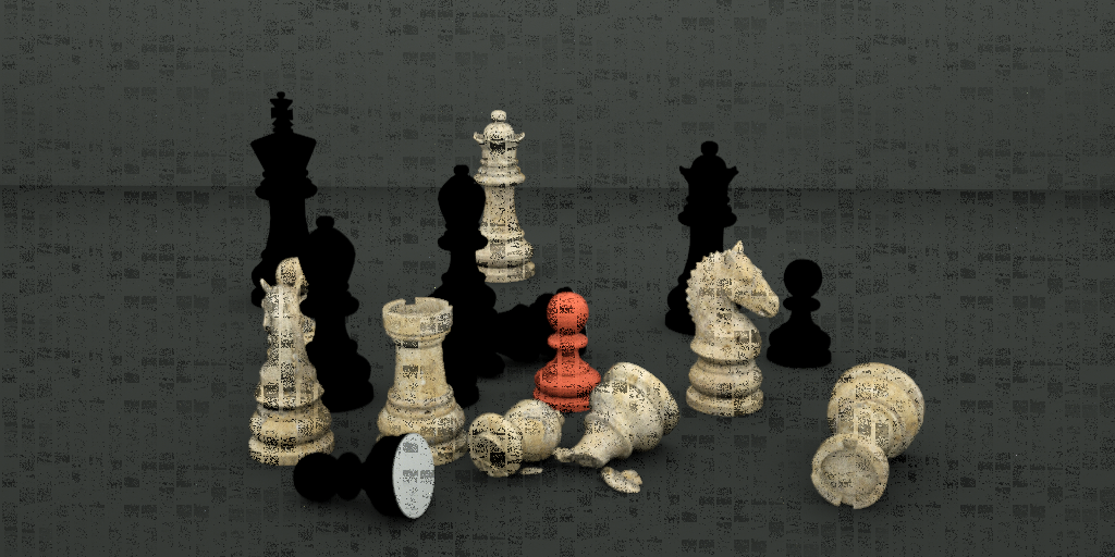

afecelis wrote:Thanks for this new beta Radiance. I'm having 2 issues:
1. I'm getting these weird vertical lines that don't show up in beta 2.1:
2.After loading a scene, when I close the program it hangs and freezes and after a while it just shows up the "send error" message.
:D
Hey,
regarding the lines, if you switch between path tracing and directlighting kernels a few times, does it go away ?
or add a material, click on it to show the material ball, then click on your meshnode again, it should go away after some switching...
i'm investigating this...

I have also seen that when you import a obj soon as you open octane, it occurs to me the stripes like afecelis snapshot, although after change from the initial direct ligth to pathtracing is fixed.

ok, noted, i will investigate.
it's best to enable exporting of normals in blender with the HQ option too.
Radiance

Hi, "1. I'm getting these weird vertical lines that don't show up in beta 2.1:"
I get this error only with direct light.
2. I get black textures even with the chess scene but i think it is the obj file.
The space ships working well even with smooth enabled
Mib
