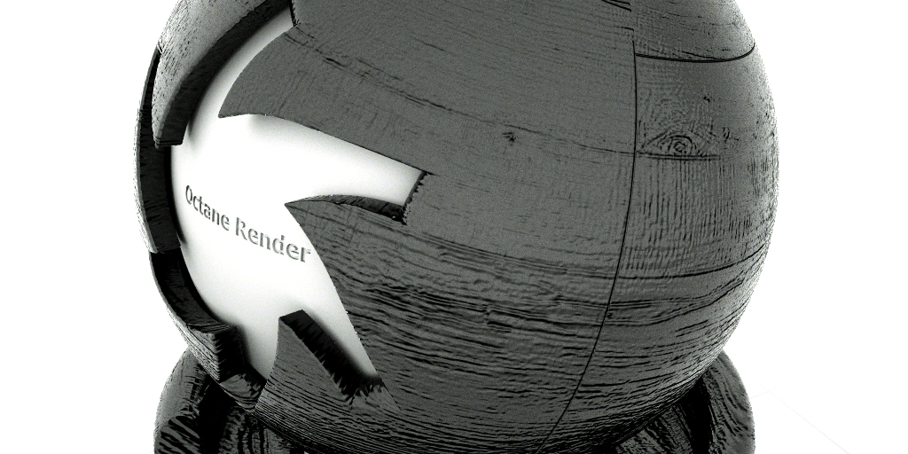

I made a quick test with mib2berlin's normal map (see previous post).
1st pic is the Normal map used as an "Image" in the Normal setting.
2nd pic is the same map used as a "FloatImage" in the Bump setting.
I used the same scale / power / gamma settings in both.
=> I much prefer the Bump one, as it is much more detailed !
