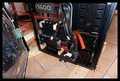

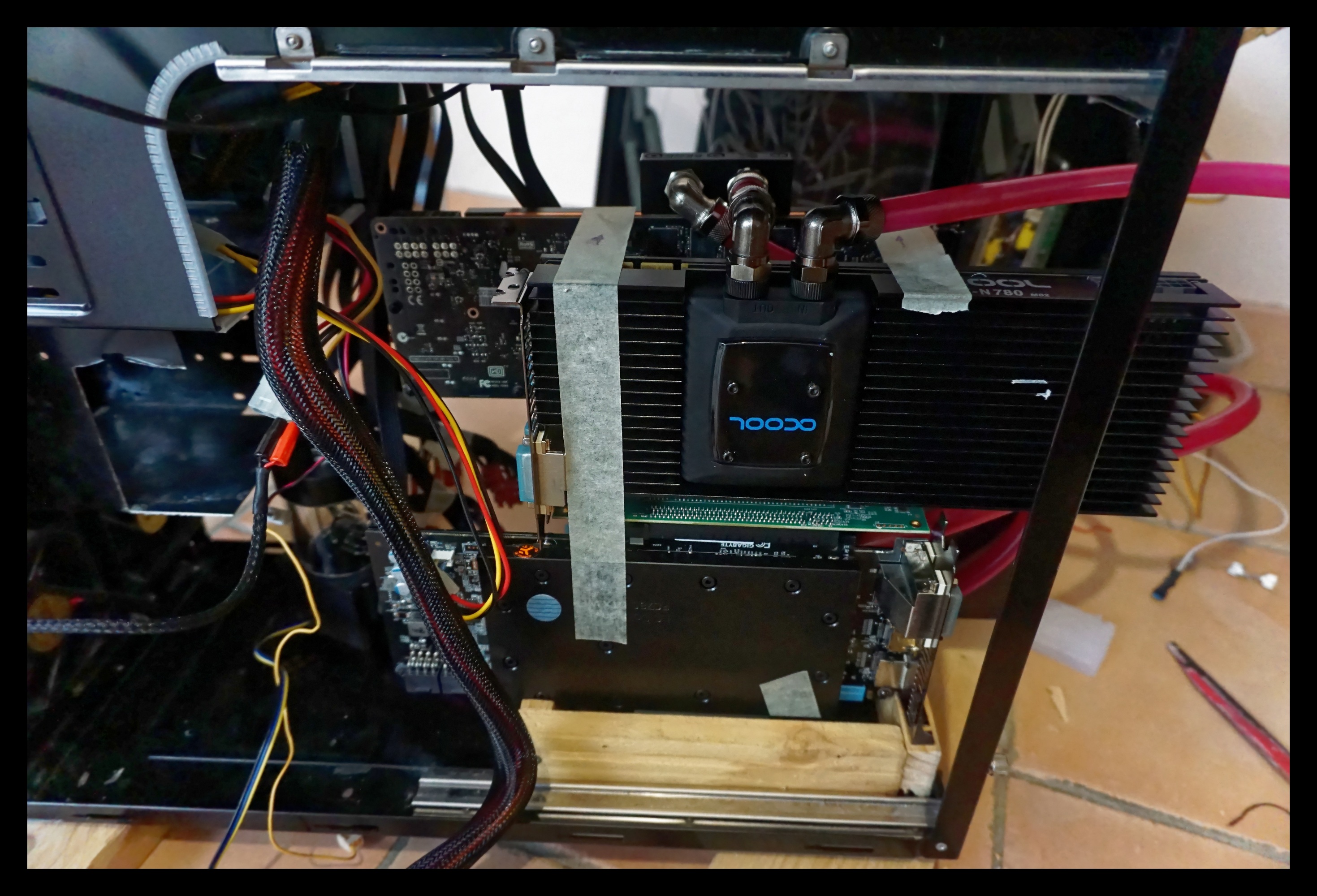

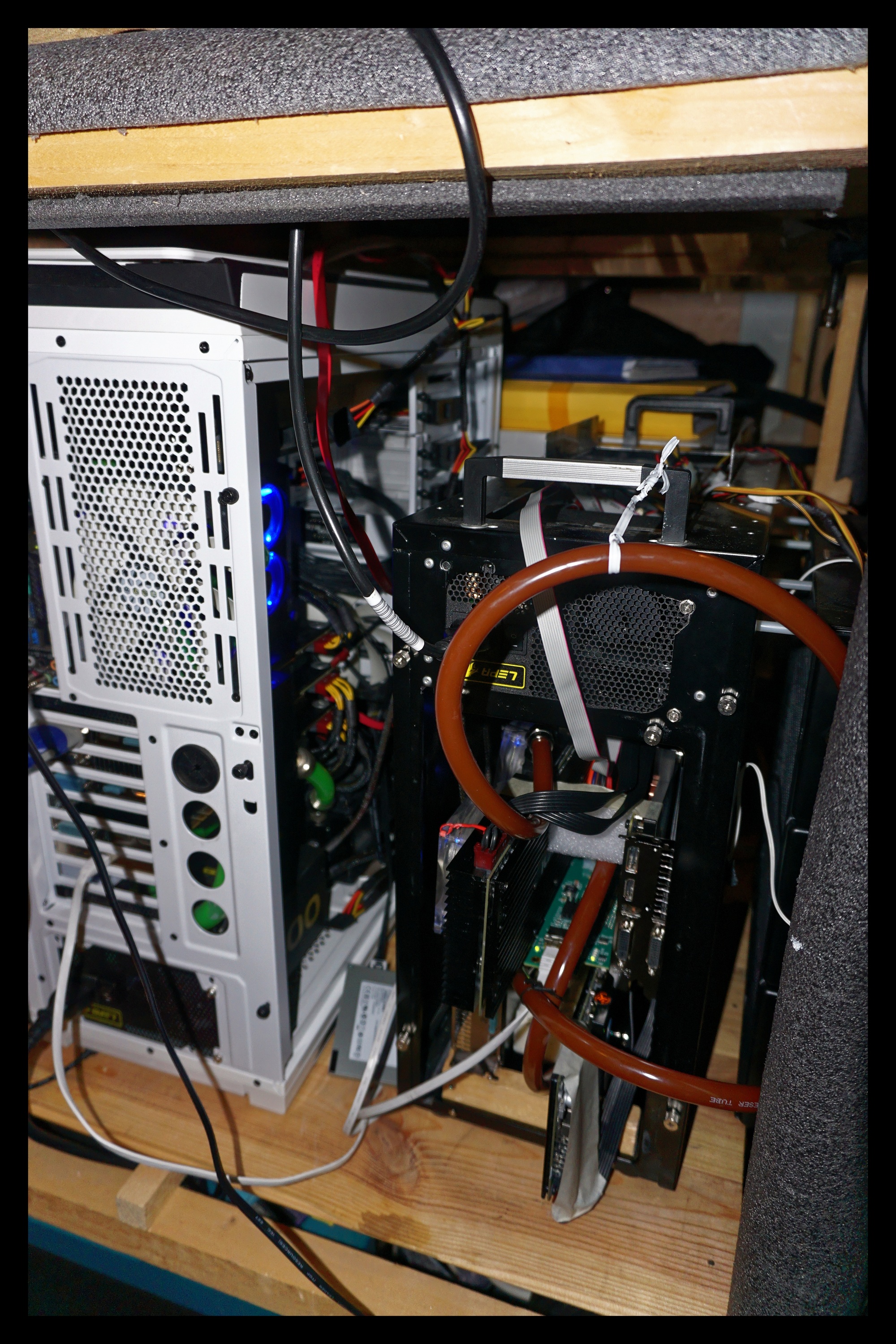

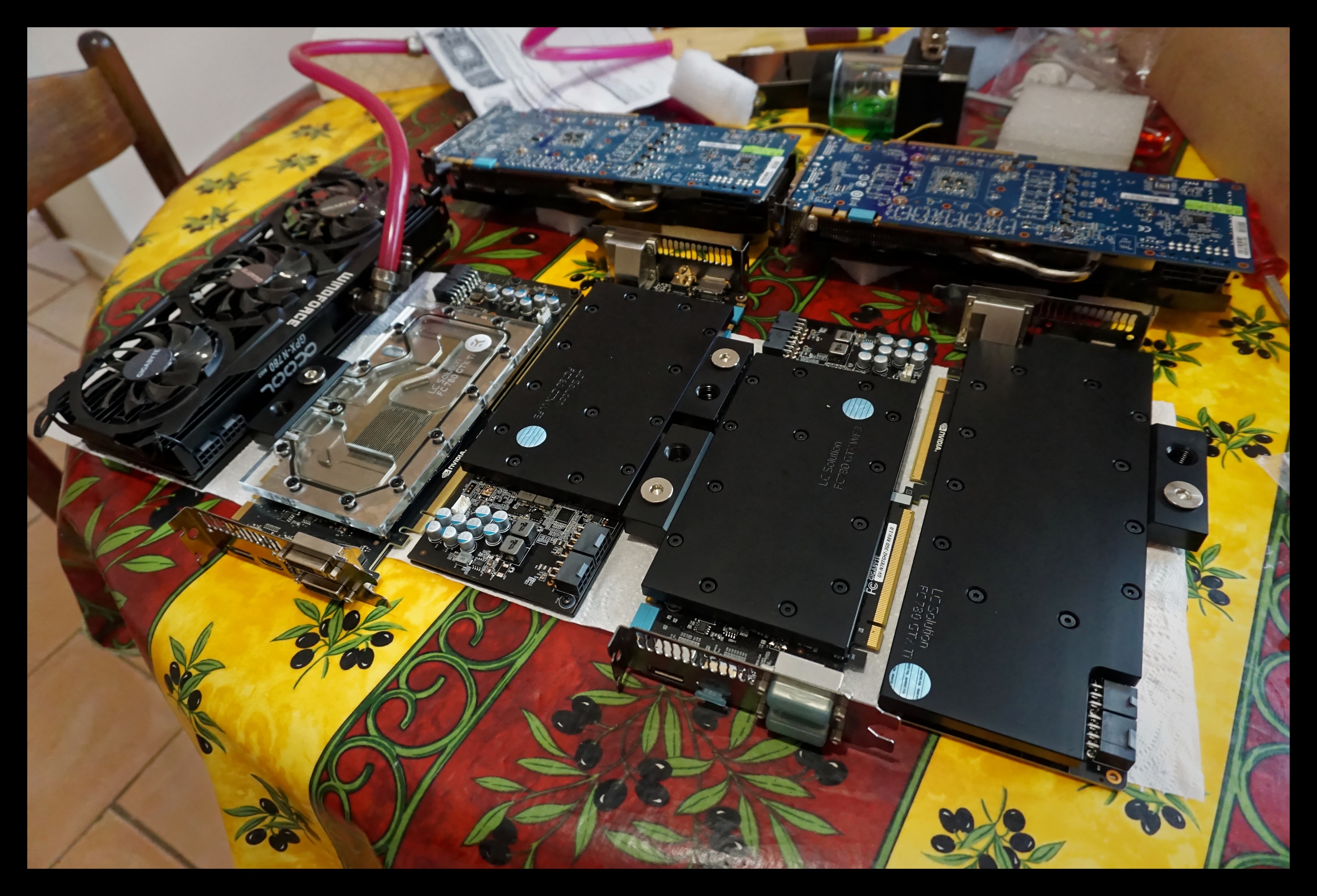

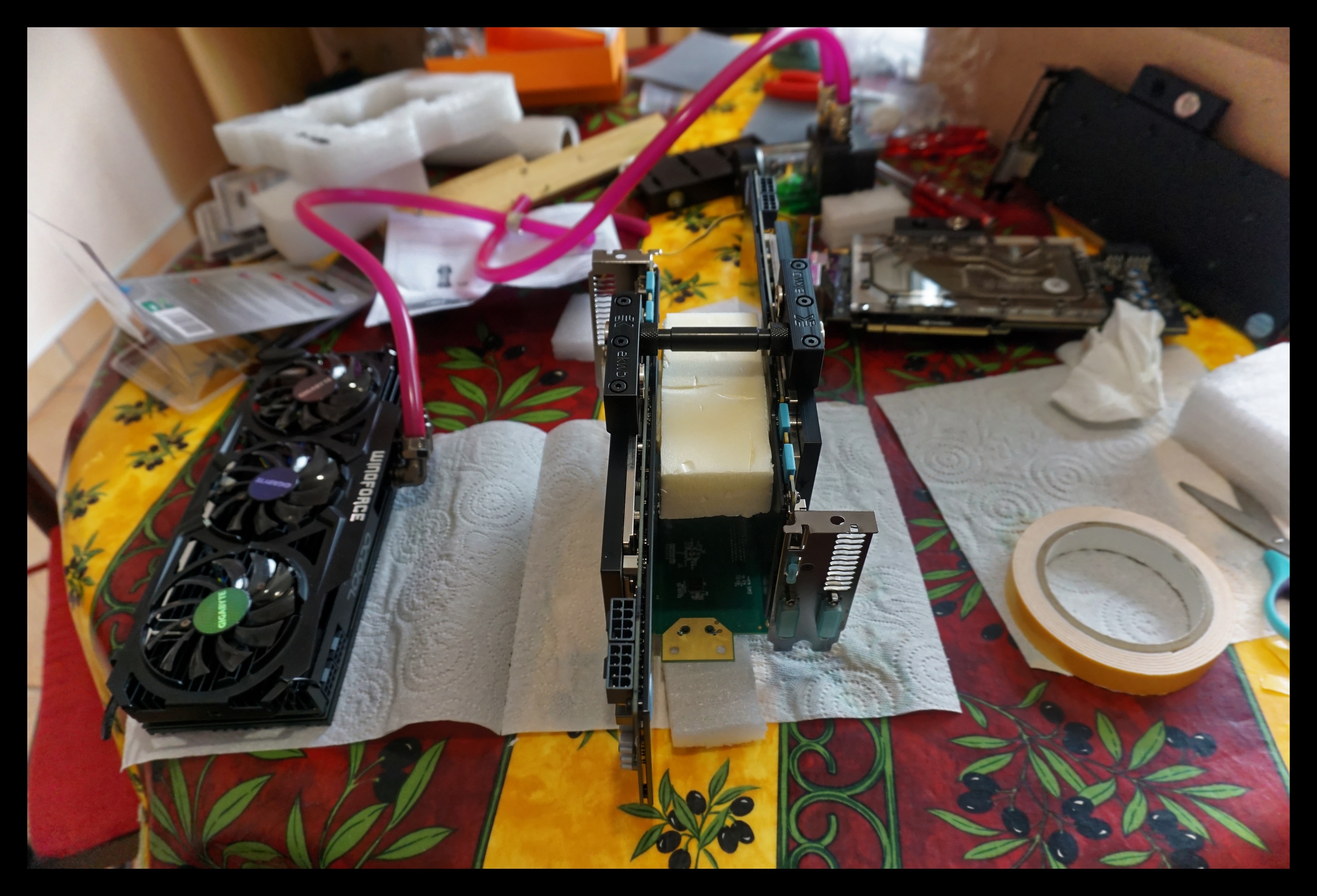

Take 4 hours to change the splitter to cluster :
Dispatch all external boards...
Installing the cluster (version 1.2)...
Into the chassis.
Connected to the main PC.

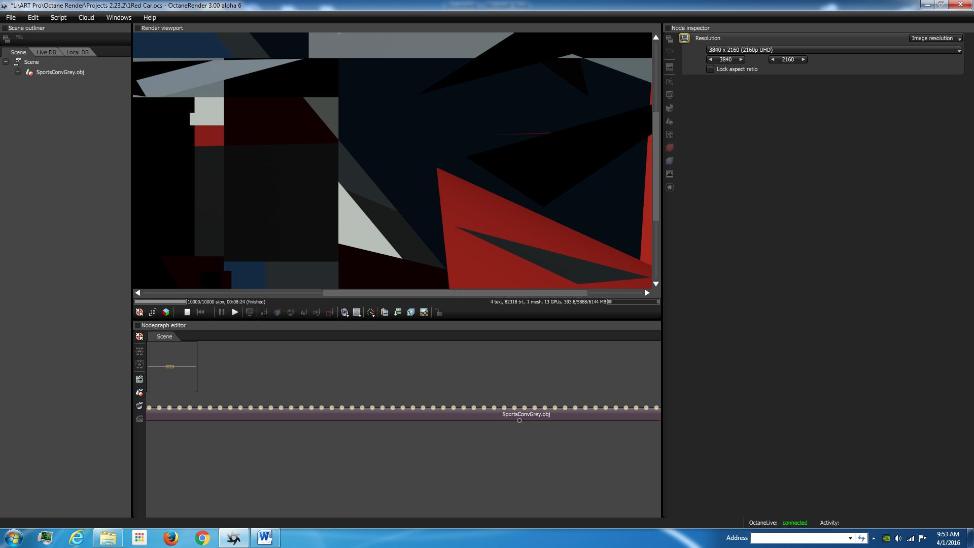

And ... Works ! no freeze with the red car (baking cam and high resolution up to 8000). YEP ! :D
I7-3930K 64Go RAM Win8.1pro , main 3 titans + 780Ti
Xeon 2696V3 64Go RAM Win8.1/win10/win7, 2x 1080Ti + 3x 980Ti + 2x Titan Black
Awesome Itou, great work and great news!
Your work also paid off for me, it fixed my issue as well!
Full GPU complement, 3840x2160

By the way...twisty ties, tape, styrofoam...LOVE IT...Beautiful
Your hands must be killing you with those screws... ;)

No way, I can only put 9 GPUs. when try the 10th, cannot boot (BIOS error 0xd4 : out of ressources) and no 4G option on my P9X79 deluxe :cry:
Ha also, I mod another Titan single slot to put in my main PC.
So now 4 internal GPU and 5 external GPU.
