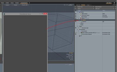

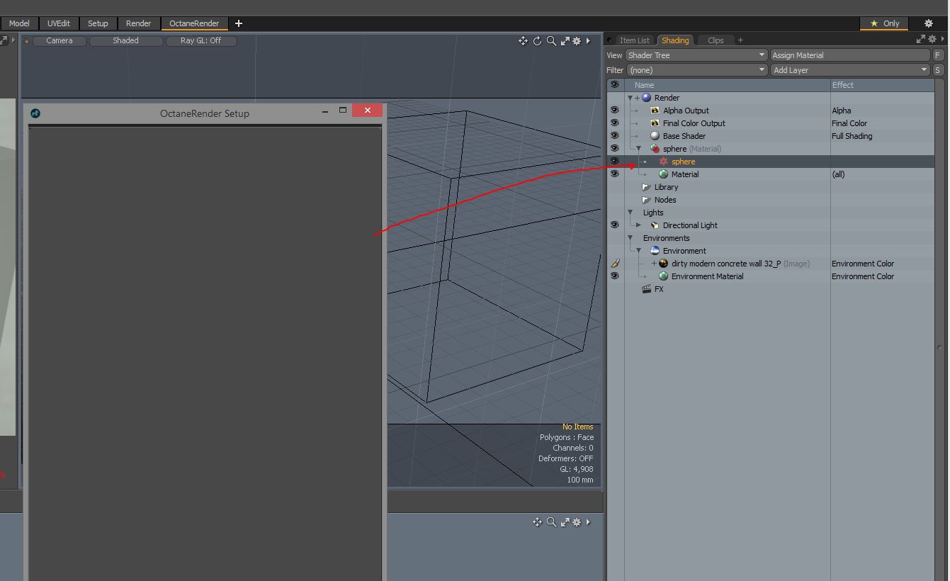

Hi, I decide to buy the plugin for modo but I guess there was something going wrong on Installation.
Or I did mess it up by accident .. however: If I click on the overwrite material, a blank popup come up in Modo 901 ..
I did try a reinstall of the plugin without success.
screenshot
screenshot
voto.1979
Windows 8.1 / Octane Standalone Application / GTX Titan Black 6GB + GTX 970 / Intel Core i7-4930K CPU @ 3.40GHZ (6 Core / 12 Threads) / LG 34UC87
face_off
Posts: 15812
Location: Adelaide, Australia
I suggest deleting you Modo901.cfg.
Paul

It works for now but I lost all my personal setups in Modo (shortcuts and menus).
But the automatic popup is not very useful and kind of distractive if I am in the Octane Render Tab in Modo 901. Because it open the menu which is already open.
voto.1979
funk
Posts: 1207
Joined: Mon Feb 07, 2011 1:24 pm
Location: Australia
You can disable that in the octane preferences.
eg. preferences > rendering > octane > open octanerender setup window on creation/selection
Paul, maybe you should disable that stuff in the 901 plugin by default
