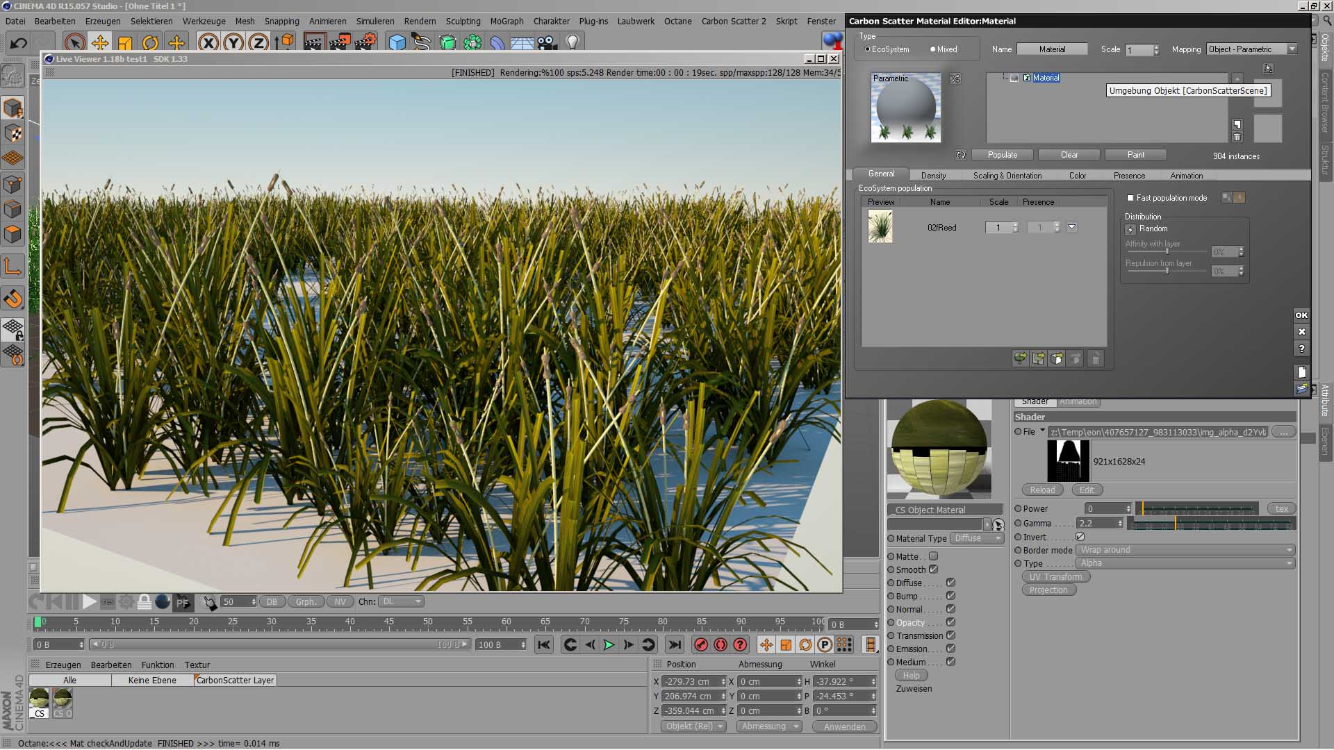

Rudi wrote:
Malaurny wrote:@ aoctar: Good news, Carbon Scatter works great with v1.18b Excellent job, thank you.
That's true but anyway not not, Malaurny.
Hi Rudi,
It's working for me on R15 with v1.18b
https://www.dropbox.com/s/rf0ya67icufxh ... 5_1.18.jpg

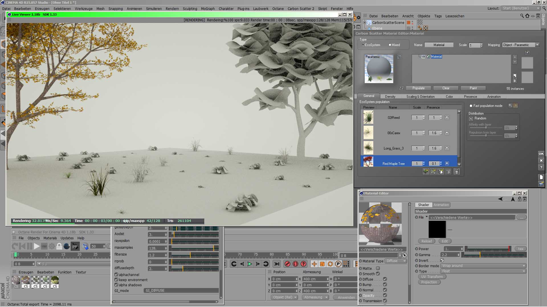

aoktar wrote:
The attachment CS2_fail.jpg is no longer available
i have tested on r13. it was working, can you try a few more plants?
It has changed nothing at all. The copies are still without color and the Alphachannel it is not evaluated.
The originals are okay if one switches of alpha to Float.

Rudi
Posts: 188
Joined: Sun Sep 01, 2013 7:05 pm
It goes, nevertheless .:)
I had the wrong version.
With 1.18b gehts not, but with 1.18b_test everything functions.
Also alpha if one regulates power on zero.
Thanks aoktar and excuse for the misunderstanding.

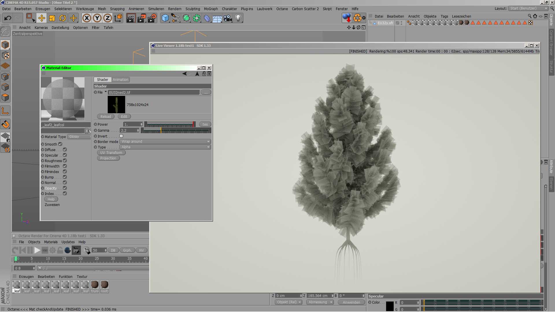

Someone can try this for R14/R15?
http://render.otoy.com/customerdownload ... -test1.zip
New problem.
With 118b-test1 goes Carbon Scatter models.
But xfroq does not go at all.: (
No counter has an effect. Only this is to be seen always how it looks in the picture.
