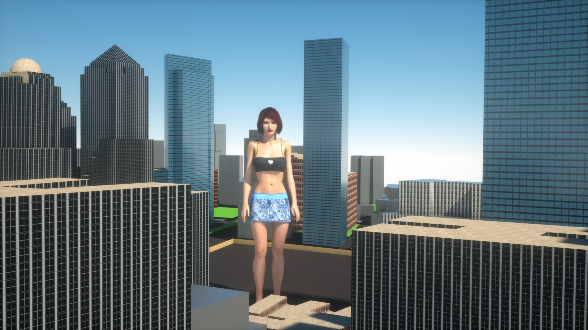

Notiusweb
Posts: 1285
Paul, this is AWESOME. So much for Daz plugin limitation 8-)
(The zoom was for the other background, so it looks weird on a transplanted scene. But that's my bad, not the plugin's ;) )
THANK YOU!!!
CityWalk2.mp4
Some Alembic action
(3.34 MiB) Downloaded 3978 times
What was I thinking...I should have made it like this...
