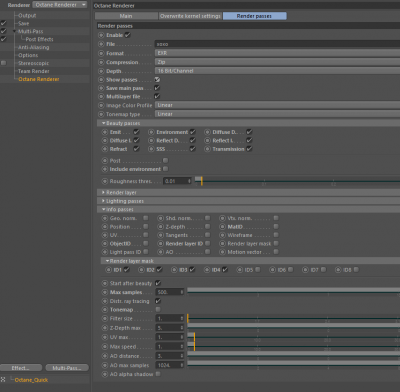

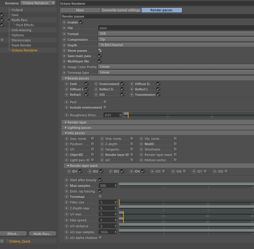

Hi, I'm having a problem saving out multilayer EXRs. Saving the passes as discrete files seems to work fine but multilayer makes a file that appears to be the correct file size but is basically empty/black when opened.
Am I doing something obviously wrong?
Thanks..
