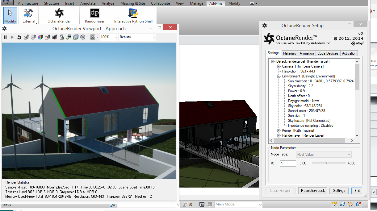

With Daylight Environment, you can illuminate with the sun only, in which case the sun direction is taken from Revit and the shadow sharpness can be controlled via the Sun Size.

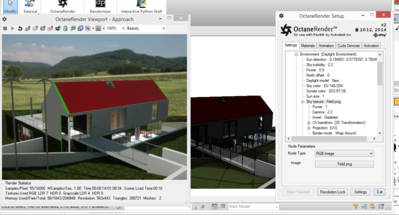

With the Daylight Environment you can also assign a background image. In this case, the shadows and lighting is determined from both the the sun direction, power and size, AND the background image.

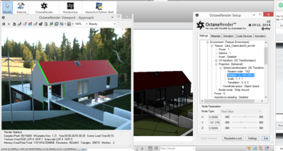

Alternatively, you can use the Texture Environment, in which case the Revit sun is ignored. If using this option, use a high quality HDRI map, which a bright sun in the image if you ant shadows. Set the Image gamma to 1. You can rotate the HDRI image via the Spherical Projection Rotation slider (as shown) - which will rotate the sun direction (if a sun is present in the HDRI map).
