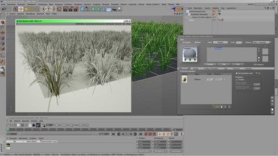

Malaurny
Posts: 22
Joined: Tue Jun 18, 2013 9:51 pm
Location: France
@ aoctar: Good news, Carbon Scatter works great with v1.18b Excellent job, thank you.

Posts: 16066
Location: Türkiye
Rudi wrote:
Malaurny wrote:@ aoctar: Good news, Carbon Scatter works great with v1.18b Excellent job, thank you.
That's true but anyway not not, Malaurny.
i have tested on r13. it was working, can you try a few more plants?
