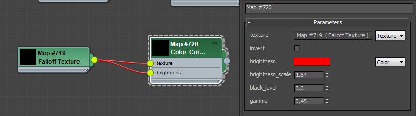

- another bug, I encountered - if that even helps anymore, cause we might be introduced to entirely new bugs :)
- the color correction node - when you copy/paste it, or ctr-shift-alt drag inside the slate material editor - it tends to override something in this situation - when you drag copy it it returns it into texture node
- when both of those nodes are attached to it, and you change the texture to a colour - it tends to turn the color settings into a texture -
- keep it in mind anyway or list is a bug - because I kept on getting strange results because I had 15 nodes for a material, and couldnt figure out what it was - this can crop up as a problem -
- mind you, if you copy it inside a material editor, and than drag it back it's ok, only when you ctr+shit+alt drag drop it inside node editor, which I do a lot, because I can

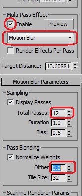

solomon wrote:Karba, what is the best way to use motionblur in 3DS Max with the Octane Plugin?
The only way to do Motion Blur in 3dsmax is using Multi-Pass Effect in standard camera. Set it to Motion Blur. Dither to zero. And don't forget to reduce samples per pixel amount by Total passes amount
