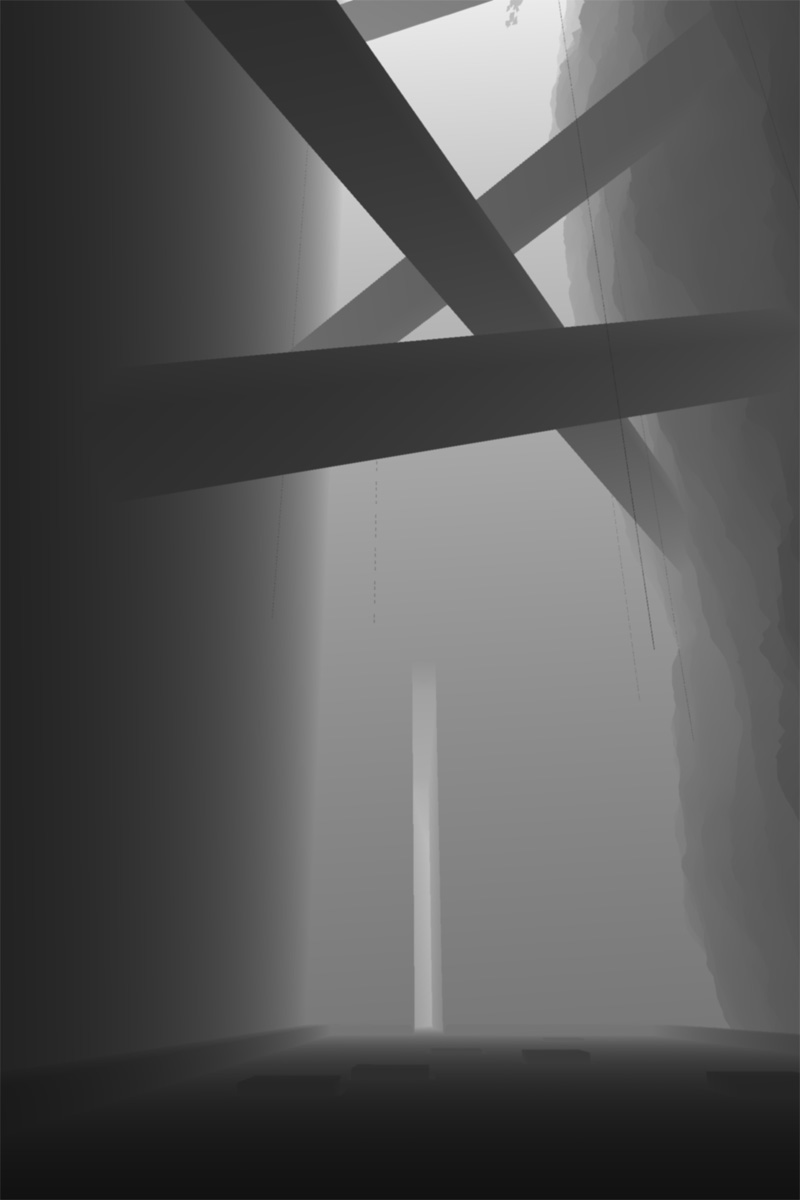

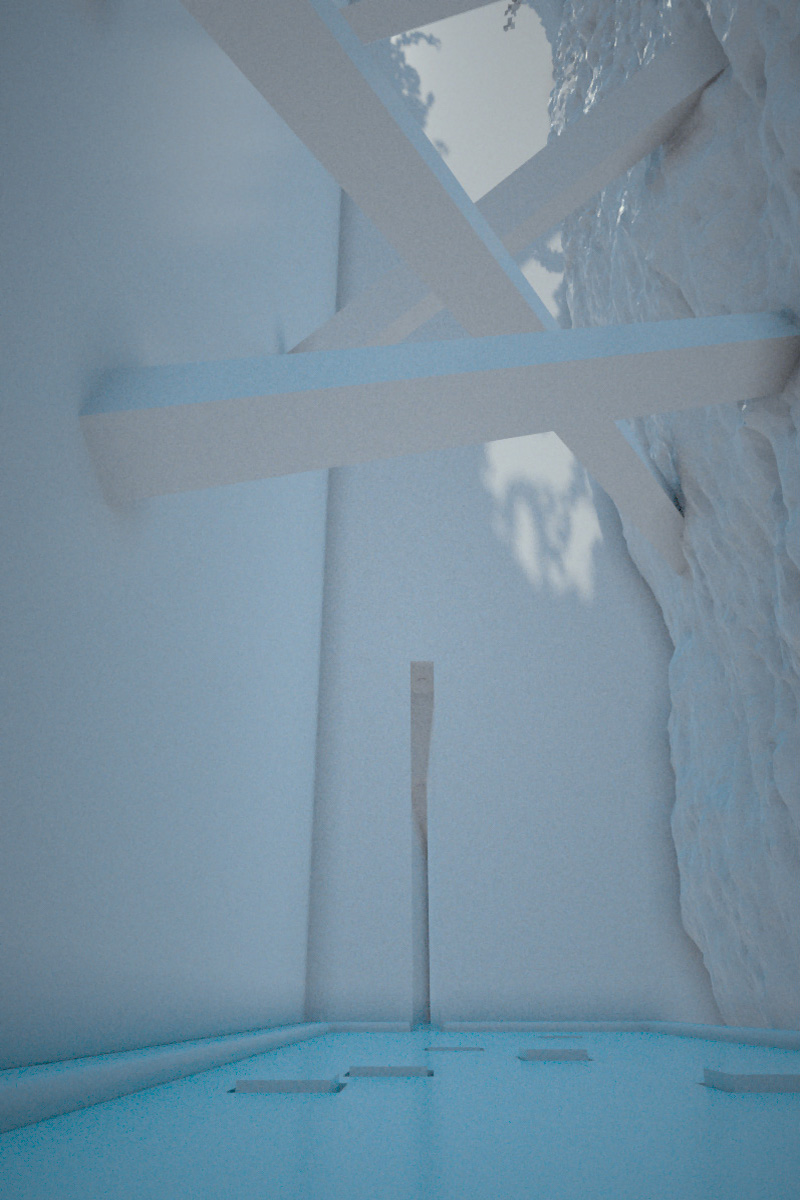

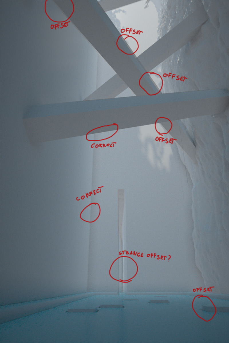

enricocerica wrote: Could you give more details about those problems as I really can't point them ?
Here are the example renders, one from Octane and z-depth pass from Blender (rendered in doubled resolution, gaussian blur filter with 1px radius, and then scaled to 1200x800).
