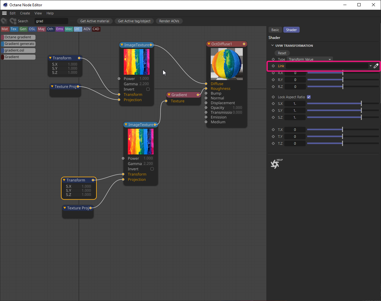

New link parameter in Octane transform node. You can read transform matrix of any object with this option.
Hey guys,
Can somebody please explain me how this works? What type of other object am I supposed to click on using the eyedropper? (Nothing appears in the drop down)
Thank you.
frankmci
Posts: 917
Location: Washington DC
bokasonic wrote: Can somebody please explain me how this works? What type of other object am I supposed to click on using the eyedropper? (Nothing appears in the drop down)
You can use the attributes of any object in world space to drive the Texture Transformation values, either by picking the source object with the eyedropper or by dragging and dropping an object from the Outliner into the "Link" field. The XYZ to UVW option in the Projection node works similarly, and you might find it a bit more intuitive to begin with. I suggest playing around with that, first. Once you get the hang of the relationships between manipulating objects in world space and their effects on texture Projection space, I think you'll find the 3D Transform option easier to wrap your head around.
bokasonic
Posts: 8
Joined: Fri Aug 31, 2018 8:45 pm
Thank you frankmci, this helped a lot!

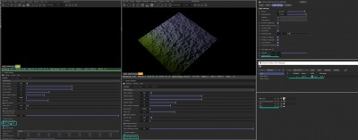

When objects are disabled inside Scatter - nothing happens :
But doing the same with instances inside Scatter works as expected :
Disabling object inside C4D Cloner works fine too.
Disabling Cloner makes that all objects inside Cloner are visible in renderer on their original positions. Doing the same with Scatter ( disabling Scatter ) pernamently disable objects inside it from renderer - they are not visible on their original positions.
Render visibility for objects doesn't work. It works for instances inside Scatter only :

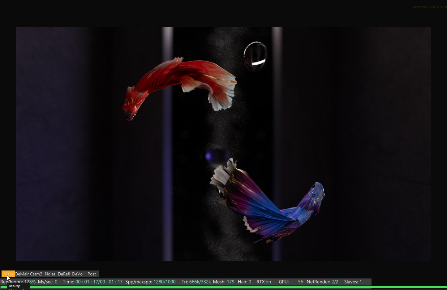

Is the denoiser broken when working with a visible environment?
Main Pass:
Main pass
Main pass
Denoised Pass:
Denoised pass
Denoised pass
I had a volume, I tried with "denoise volume", didn't work so I turned off the volume.
Pattracing, last version. 2022.1-R4
Thanks!
