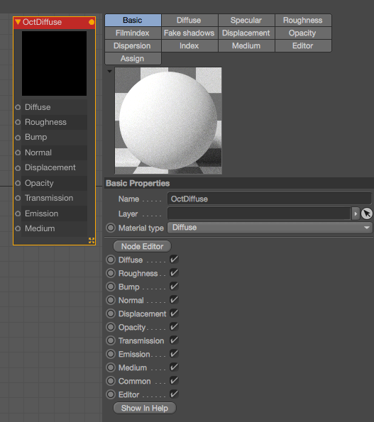

mr_seq wrote:I just installed the R2 update and it seems like the "Emission" tab has disappeared from the material?
(In the attributes manager, it's still there in the node editor)
Am I the only one with this problem?
Confusing. You're on diffuse type and tabs belong to specular type.
I can also confirm this issue in R15, 17 and 18.

nycjunglist wrote: I can also confirm this issue in R15, 17 and 18.
Could you pls check with this version?

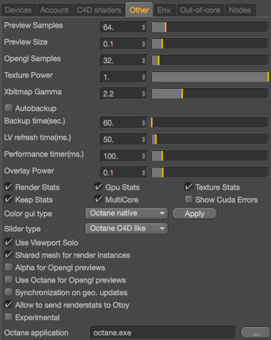

Is it still the case that the LV is always one step behind, when adjusting anything? Lights, colours, materials. Change the light value, hit enter... nothing. Change it again, the LV shows the value you first changed it to.
It's a really frustrating way to work when you have to set a value twice just to see the change update. Makes it hard to A/B two different values or even work quickly.
Apologies if this has already be asked, did a search and came up with this being a problem in 2.14 I think and so should have been solved well by v3?
Also, some clones not showing in LV when render instances are on. Some of the clones from cloner show, random ones do not.

sbstnc wrote:Is it still the case that the LV is always one step behind, when adjusting anything? Lights, colours, materials. Change the light value, hit enter... nothing. Change it again, the LV shows the value you first changed it to.
1-Do you have any proof for this issue? I don't never see. I'm using this plugin everyday. And I'd be fixed that if there's so serious problem. You may have a partial problem with your settings. I can't be happy to see this kind of keen words. Have you ever asked for a fix for that if there's a problem we couldn't see?
2-What's it? You can't use render_instances inside of another render_instances. It's our limitation.

Thanks Aoktar, I didn't realise about the render instances inside render instances, that was indeed what I was doing. I have corrected my scene, thanks!
The LV update has been an issue for me in every single version for v3 release on MacOS C4D (or at least 3.03, 3.04, 3.05, I started using Octane with 3.03).
Is it a settings thing? Any change I do, I have to make 2 actions for Octane to update. Which is either, apply the value twice for the parameter (eg, set value and hit enter, set same value and hit enter), or set value, then click an object or move the camera or do something that is a second action, to cause Octane LV to update.
My settings are default as attached screen grab.

@sbstnc: Could you pls check it with "sync on geo. updates"? Because it's not happening on me or someone else as i know.

sbstnc
Posts: 120
Joined: Mon Jul 25, 2016 1:21 am
That's fixed it, thank you so much for pointing me in the right direction. This is so much better to work with!
As it was not the default (I don't think?) I did not assume that changing this would lead to a better experience for me.

sbstnc wrote:That's fixed it, thank you so much for pointing me in the right direction. This is so much better to work with!
It's not default for OSX version. Because it causes problems on multi-view mode in viewports of OSX. Btw we have to test it again after your post. But it doesn't work as you said. And nobody says that too. That's strange. You may think to update C4D.
