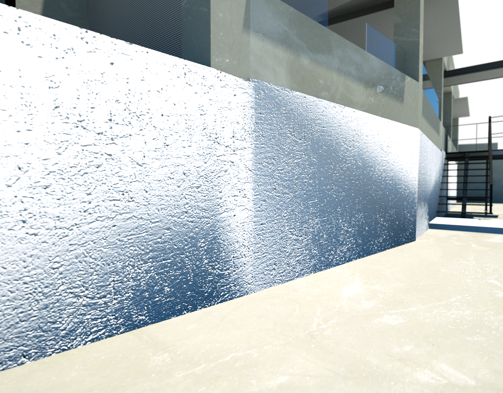

I believe there is a problem with the model and the displacement.
I have to filter out what exactly causes this. I hope it is not a matter of too much calculation.
In any case I applied displacement to a different surface in my model with smooth and it worked.
Only problem it looks strange with some shadows. I tried it again with a couple of walls and it worked just fine.
Smooth
Smooth

Just tried with the 4.0 version and got the same results.
I found the log text which is:
Started logging on 21.03.18 18:28:08
OctaneRender 4.00 XB1 (experimental build) (4000001)
failed to unregister shared pinned memory
CUDA error 719 on device 0: unspecified launch failure
-> kernel execution failed(report)
-> failed to launch kernel(ptBrdf2)
device 0: direct light kernel failed
CUDA error 719 on device 2: unspecified launch failure
-> could not get memory info
-> failed to load symbol data to the device(deep_data)
device 2: failed to upload the deep params
device 0: failed to upload the deep params
It is strange that the error is probably model depended. Any idea why this is happening?
