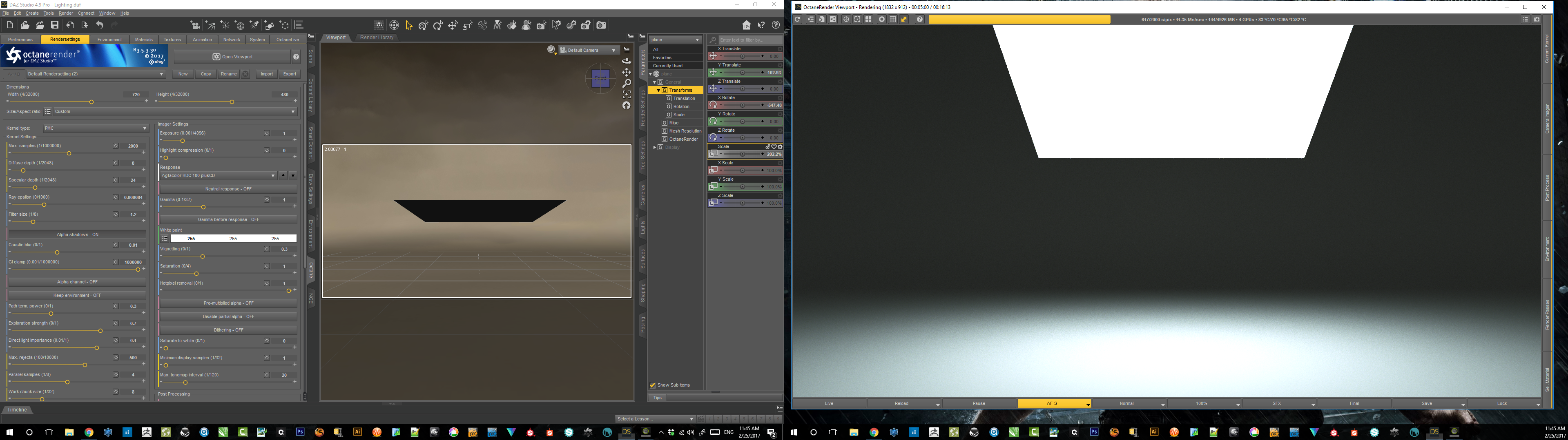

Running R3.5.3.30 and still having some issues with object scaling and transforming not updating on the fly. Having to force reload ( doesn't always work ) or change the Kernal Type to see modifications / update render.
Screenshot attached.
