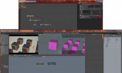

OCS is fixed, thank you! But there is one detail I am not sure it shall work like it is now: namely, when I have a simple cube to which a very complex ocs is connected as a proxy and I want to replicate it (the proxy) by replicating the cube as a modo instance - proxy is gone and I can only see cubes in octane viewport. To get a copy of proxy I cannot use an instance of a cube but a regular copy of a cube. Is it clear what I am saying?
I understand what you are asking for. The original feature request for proxies did not mention this requirement, so the proxy implementation only works with Modo Mesh items, and not instances of Mesh items. Supporting instances of proxied mesh items may not be easy to implement - I will need to investigate further.

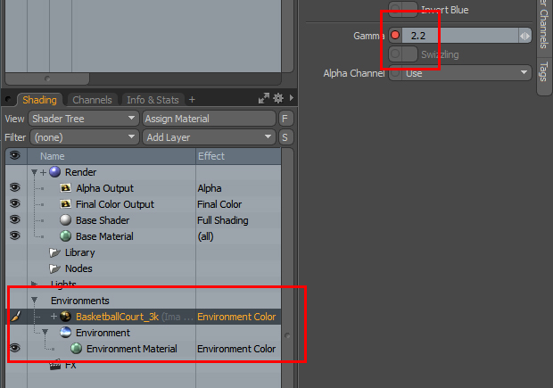

Hi paul im having an issue with the Texture Environment Gamma in the latest final build of the plugin.
Octane only seems to recognise the first key of an animated gamma amount. In the example scene attached you'll notice the texture environment gamma is keyed and changes over 3 frames. Update doesn't show in the Octane viewport only on the first keyframe.

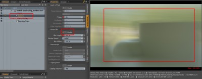

Having the same issue with Motion Blur Keying in Octane. Similar to the previous scene, this one ignores motion blur on/off for any key other than the first keyframe.
Camera motion blur is keyed and switched off but motion blur still shows in the octane viewport
Yes, the plugin is reading the environment IBL gamma at frame 0. I will change this to read from the current frame in the next release.
It's not possible to have an animation which has animated motion blur controls, because the entire camera track it loaded into Octane if motion blur is needed - so all motion blur controls are read from frame 0. If you have a sequence which goes from having motion blur to no motion blur you will need to render this out as two sequences (one with motion blur and one without).
That's good news!
Paul
That's not so good news.
Many thanks.
Paul
Paul, if this is not too much to ask please have this feature on the 'todo' list.
