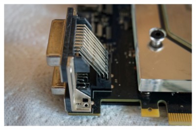

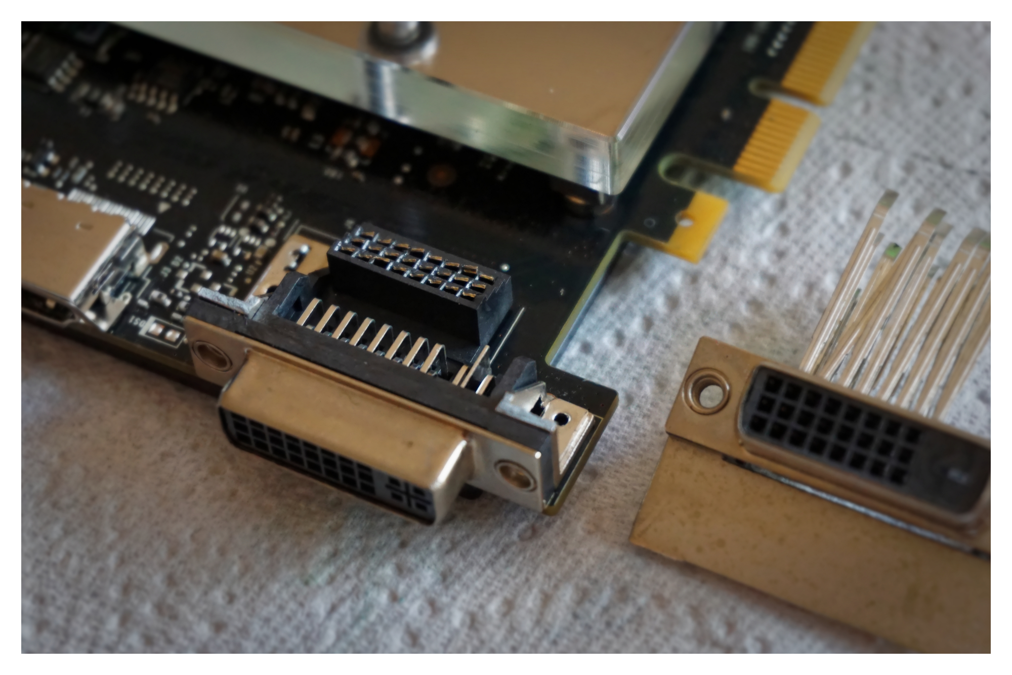

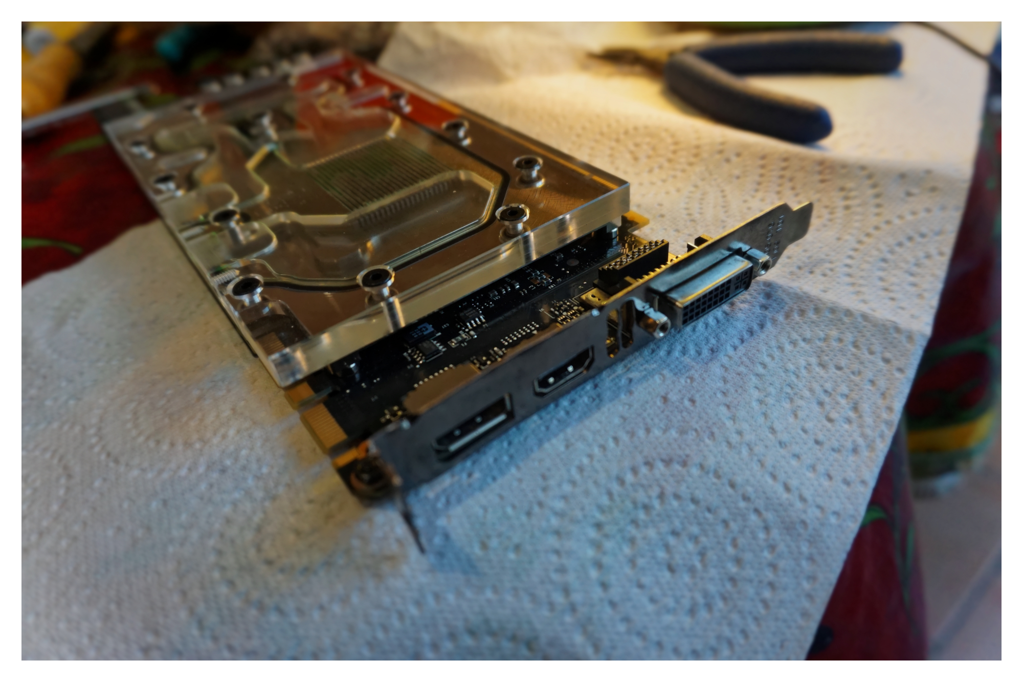

Update :
Not received yet the cluster but I have modded the two main titan to single slot to connect the splitter without riser.
Not better, still freeze on high resolution.
Some pics :
Before cut
After cut and verify there's no contact short-circuit
Final result
