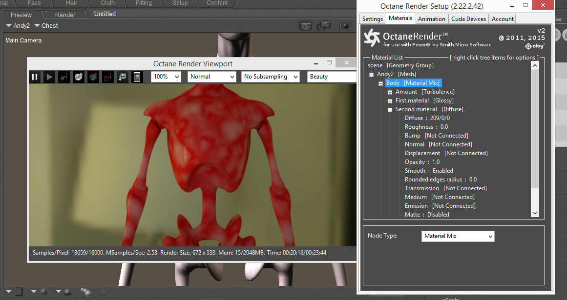

Is there a way to set the RGB colors in procedural nodes such as Checks, Saw Wave, and others? I've managed to multiply the white parts by RGB colors, but the blacks remain black. Most procedural nodes in other programs (to include Poser) allow setting colors, so I wonder if Octane will be an exception? Or perhaps there is a way to set the colors, but I haven't figured it out yet?
Plug the checks, saw, etc node into a Mix or Material Mix node, then set the second material in the mix to whatever you need.Is there a way to set the RGB colors in procedural nodes such as Checks, Saw Wave, and others? I've managed to multiply the white parts by RGB colors, but the blacks remain black. Most procedural nodes in other programs (to include Poser) allow setting colors, so I wonder if Octane will be an exception? Or perhaps there is a way to set the colors, but I haven't figured it out yet?
Paul
