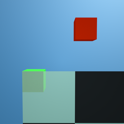

Daniel79
Posts: 451
Joined: Tue Jan 26, 2010 3:53 pm
For anyone can help me to understand!!!
I can not understand why in rhinoceros get one thing, and in Octane render it I get a completely different.
Any idea?
I used Grasshopper to define my matrices
Thank a lot
SORRY, MY ENGLISH IS BAD!
2 Xeon quad core E5440_8gb Ram_Nvidia GeForce 2GTX 780ti 3Gb/Nvidia Quadro K2000_Win10 64bit_Octane 3.02_Rhinoceros3D

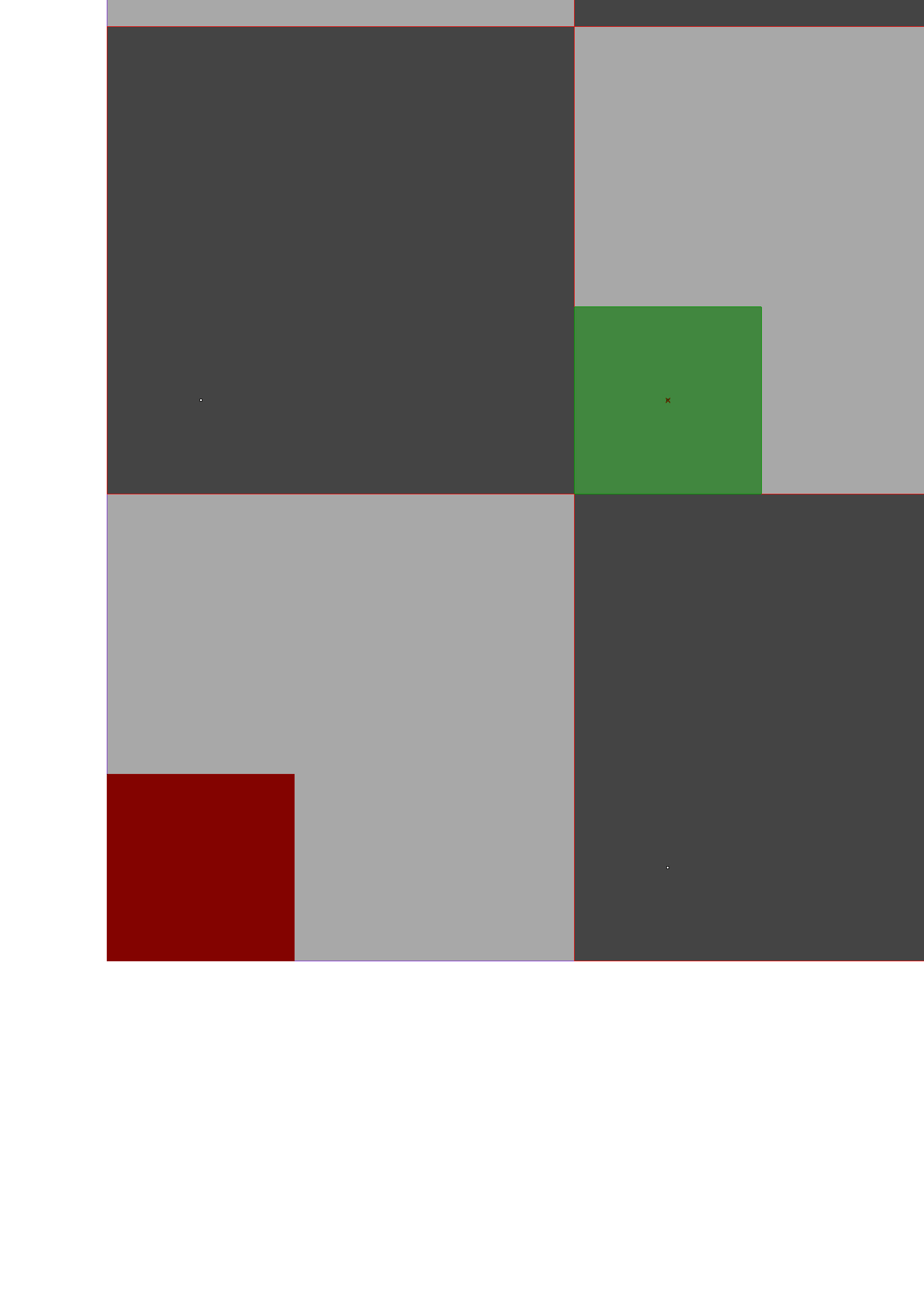

Daniel79
Posts: 451
this is the matrix that i used to traslation the box on the same green square of the green box:
[0.00, 0.00, 1.00, 5.00, 0.00, 1, 0.00, 2.00, 1.00, 0.00, 0.00, -5.00]
Is this wrong?
this is the result in octane...WRONG!!!
This is what i want..in rhino is OK

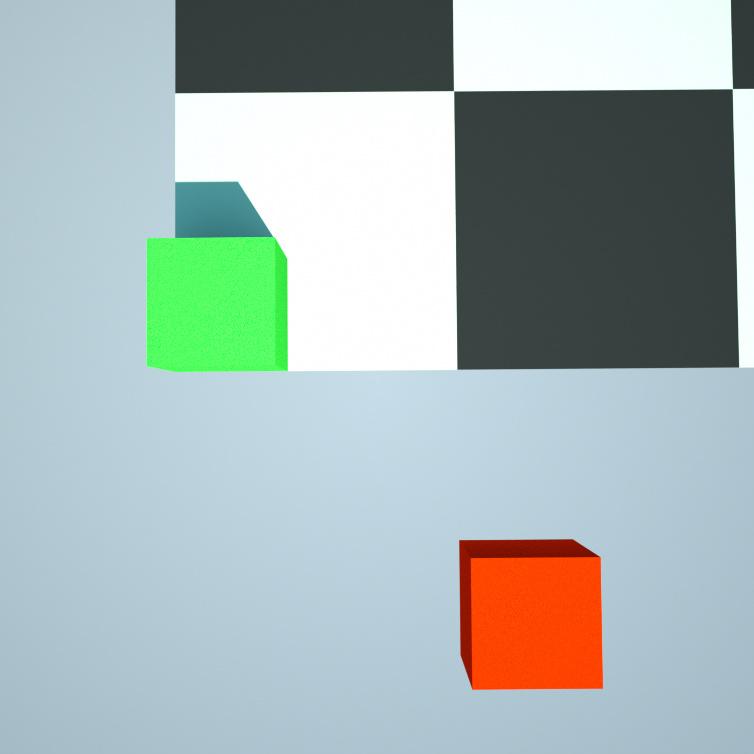

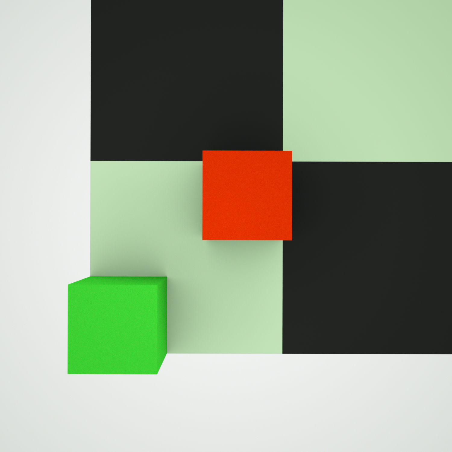

Daniel79
Posts: 451
If I write the matrix as explained roeland (1 0 0 0 1 0 tx ty tz 0 0 1), ie:
1 0 0 5 0 1 0 2 0 0 1 5
this is the result, it would be correct if looked from below upwards ...
how do I fix it?
from below upwards
from below upwards
to top
to top
