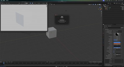

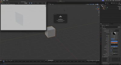

Same issue
Posts: 10633

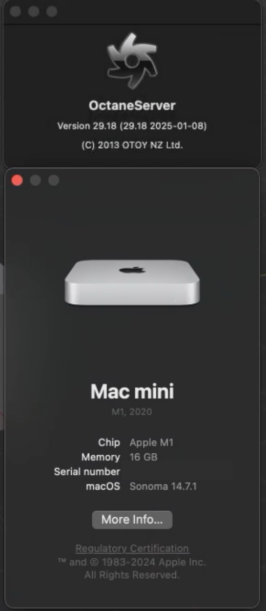

Weird, Blender Octane Server 29.18 is working with no issues here in Sonoma 14.7.1 :roll:
ciao,
Beppe

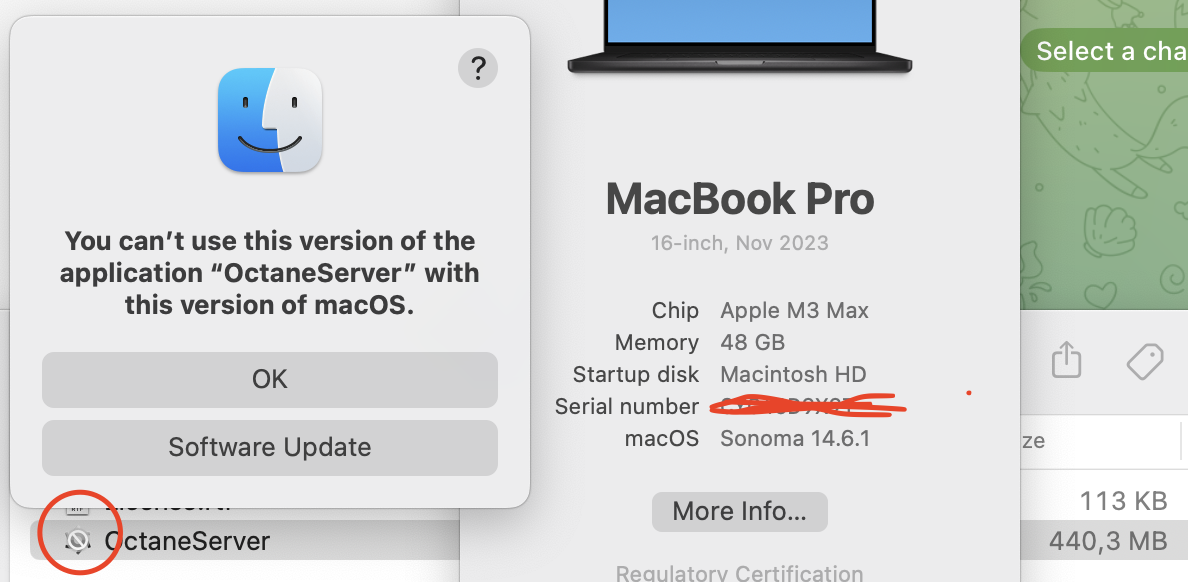

tsykhra
Posts: 16
Joined: Fri Feb 19, 2021 6:17 pm
I've asked 3 people with macs
1. MacBook Pro 2017 with Ventura 13.7.1 - crossed out
2. MacBook Air M1 with Sonoma 4.1 —crossed out
3. MacBook Pro M4 Max 16/48 with Sequoia 15.2 — OK
tsykhra
Posts: 16

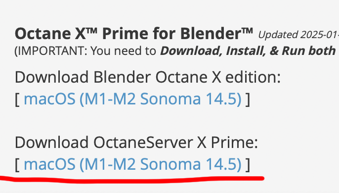

Updated MacOS to Sequoia 15.2 - Now everything is ok, so I think minimum system requirements for Octane server 29.18 is Sonoma 14.7, not 14.5 as stated on download page. I had 14.6.1

I mean just looking at the screenshots.. try updating your os…!
tsykhra
Posts: 16
cjadams wrote:I mean just looking at the screenshots.. try updating your os…!
I was confused because of this. I thought Server should work on my Ventura 14.6.1
