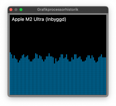

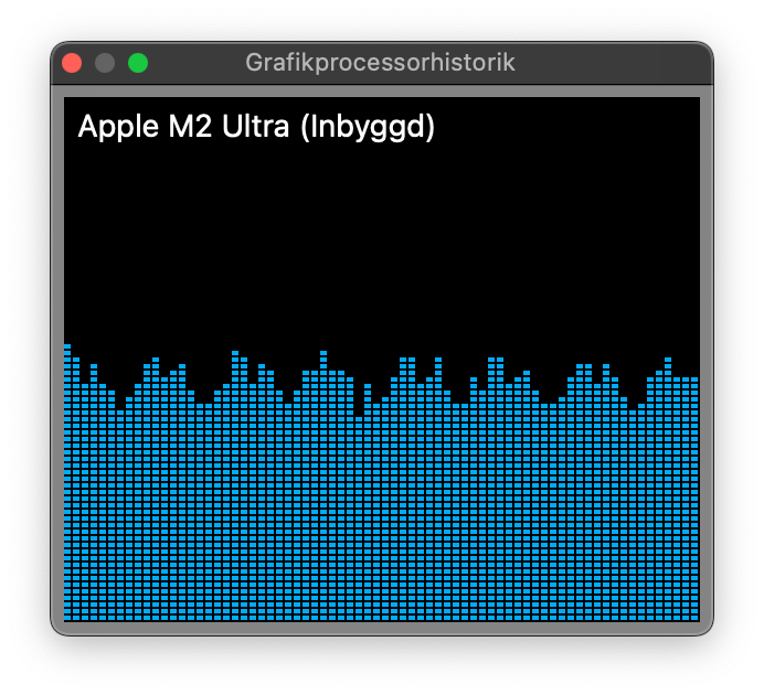

I'm running Cinema 4D 2025.0.2 and OctaneX 2024.1-R3 on macOS Sequoia 15.1. This is running on a Mac Studio M2 Ultra with 76 GPU Cores and 128 GB RAM.
No matter the render settings in regards to priority I can't get Octane to utilize more than 50% of my GPUs. Is there any known issues like this or anyone else having the same problem?
If I render a test scene in OctaneX Standalone 2024.1 it maxes out my GPUs.
Octane utlization ≈ 50%

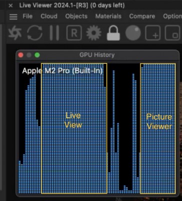

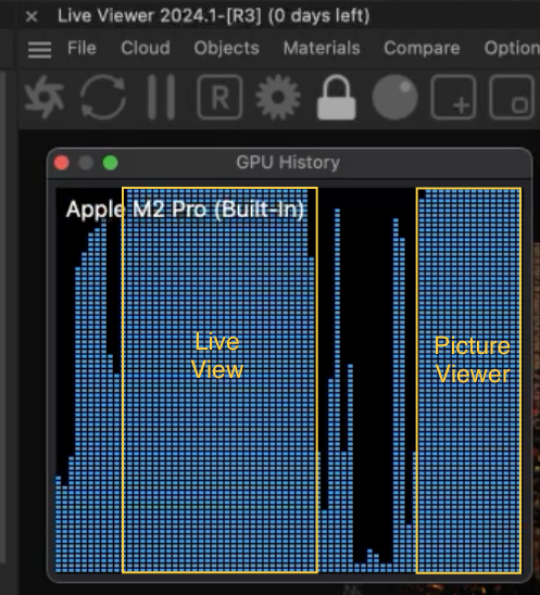

Sorry, I cannot reproduce the slowdown here, the GPU usage is 100% in both Live View and Picture Viewer, in C4D 2025.0.2 and c4doctane 2024.1-R3... but I'm working in Sonoma 14.7, not Sequoia:
Have you tried with different scenes?

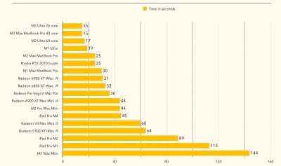

m0dm0d wrote:Octane Standalone 2024.1 / OctaneXBench_VolumeDenoiser
MacBook Pro M4 Max (40 core): 18s
(M4 Max with Realtime 16)
MacBook Pro M3 Max (40 core): 22s
(M3 Max with Realtime 19)
Thanks!
Did you connect both MacBook Pro to power supply during test?
ciao,
Beppe

bepeg4d wrote:
m0dm0d wrote: Thanks!
ciao,
Beppe
Yep, Power supply on both (same results whether 'automatic' or 'high power' in system settings).
Standalone 2024.1
M3 Max (Sonoma 14.1)
M4 Max (Sequoia 15.1)
I can't get near 15s with M3 Max (which you have listed), so I'm guessing that was an earlier Standalone version?
Would be great to see M-series results replaced with the latest standalone (if you can collect them).
That said, the M4 Max feels significantly faster than M3 Max in C4D Live Viewer C4D 2024.4.1 / Studio 2024.1-R3).
So I'm pretty happy with this upgrade!

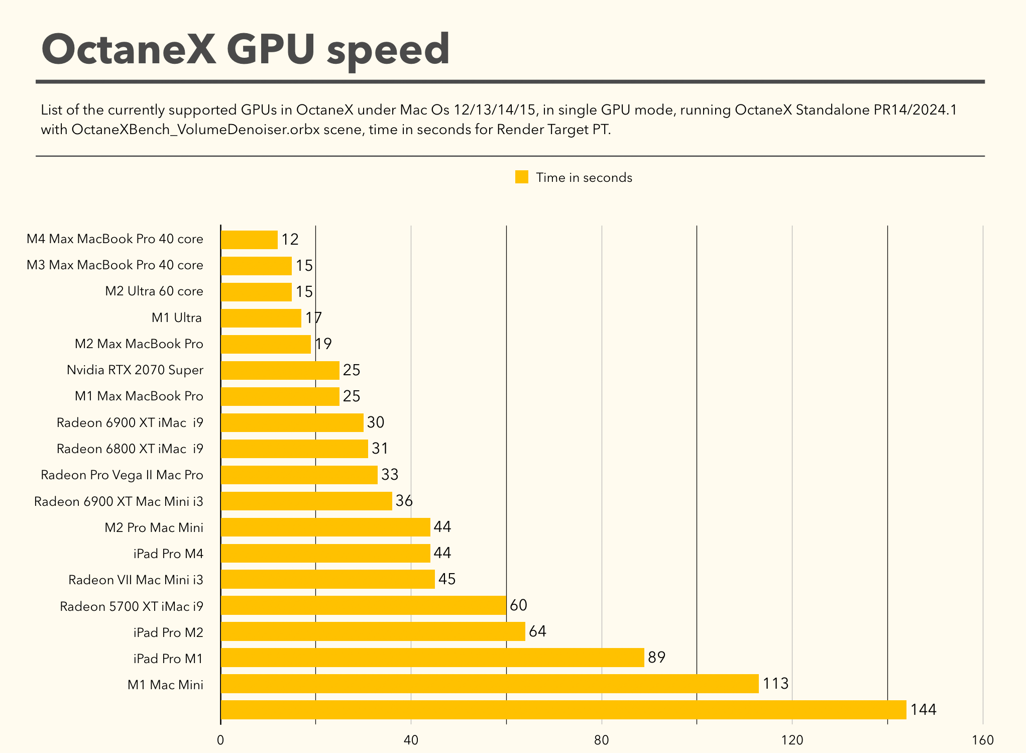

Strange results with your MacBooks :-/
My MacBook Pro M3 Max 40-Core: 15 sec
My Neu MacBook Pro M4 Max 30-Core: 12 sec
Both plugged in or on battery with same results.
Posts: 10633
Thanks davidvonbehr for confirmation on M3 Max result, and for M4 Max 30 core result!
Here is the updated chart:
Happy Mac GPU rendering!

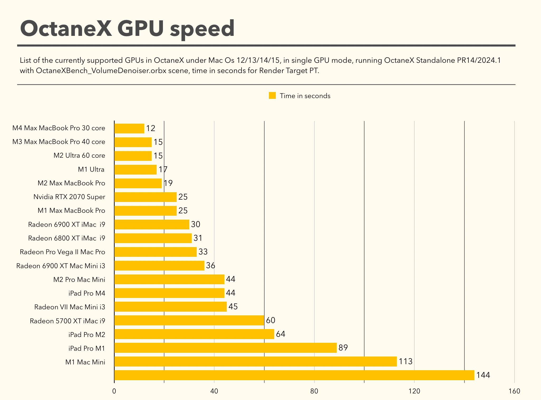

Hi Beppe,
sorry, it is a M4 Max 40-Core … it was a typo.
Posts: 10633
No problem1
Here is the corrected version:
ciao,
