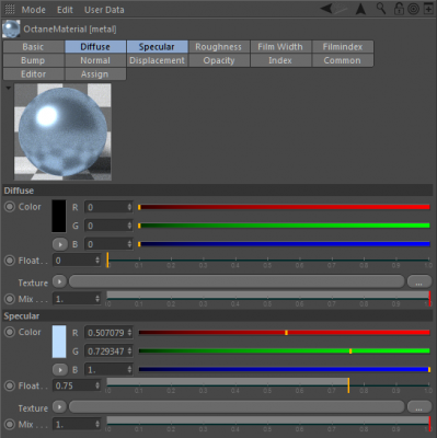

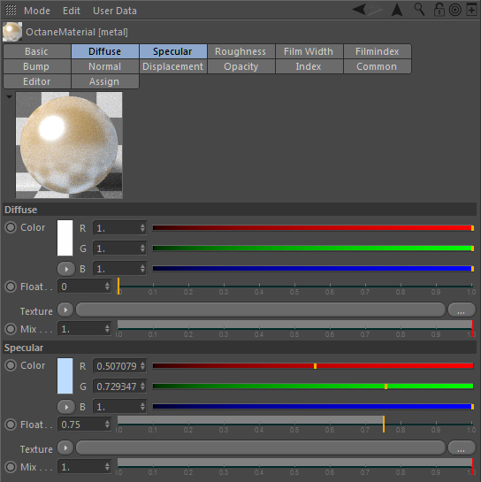

Hey everyone, I've got a question.
Am I missing something here?
As far as I know, this isn't how materials in PBR methods are supposed to behave... or is it? Speculars don't invert just because the diffuse inverts, right?
