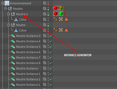

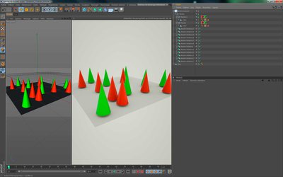

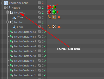

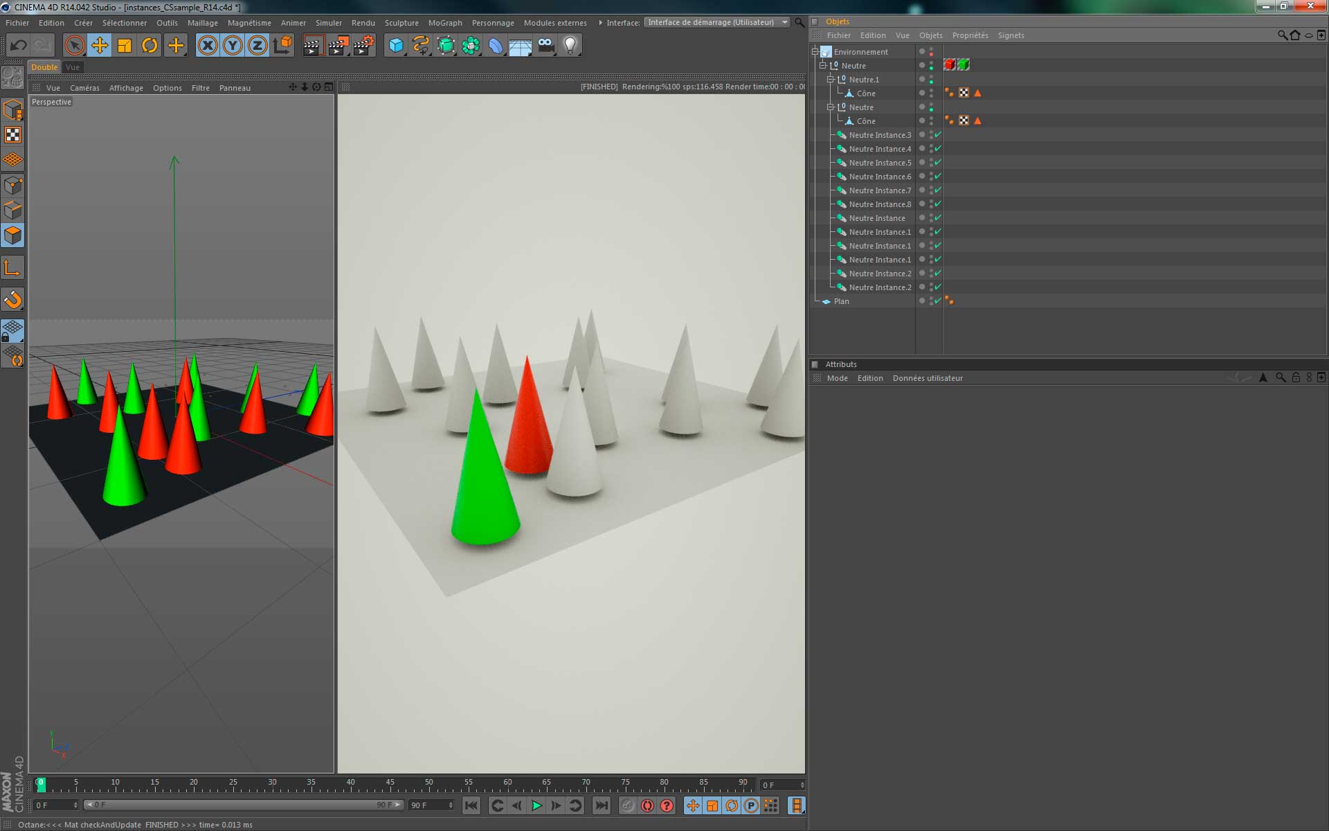

About CarbonScatter again.
I reproduced the hierarchical structure of the object CarbonScatter once edited. I get the same result: the correctly colored objects and instances without color (see broken.jpg). By moving the tag material of the first neutral object to the objects themselves, instances take colors (see working.jpg).
So I think the problem is not specific to CarbonScatter but the hierarchy of objects in relation to the Octane plugin.
I also found that if you disable the setting "make instance" of object instances, it works without moving the tags of materials. Both solutions (moving tags or desactivating "render instance") work as well but, of course, desactivating "render instance" is far heavier to render.

atome451 wrote:About CarbonScatter again.

Well,
just a explanation why this problem was occured on last versions.
For speedups, i did some revision on instance generation. Pluging looks to instance source object and childs for materials. But texture tag is not on source object. If you change the tag placement you'll see correct materials as in picture.
And, this is not a solution i know. I have to limit some extra processes to get faster feedback due of realtime checking algoritms.
But, i'm looking for a fast solution for that
