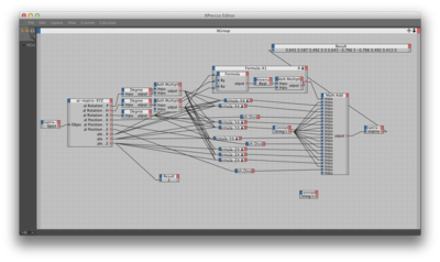

@matej: this stuff is just an excuse for studying the c4d node scripting system (something similar to XSI ICE) called xpresso. it's just a temporary solution waiting for a more professional and easy one.
Since my mathematical knowledge is really basic, i've found very hard to menage matrix and vectors; every time i've tryed to multiply a matrix i've lost myself in few minutes :)
since i must decompose the global matrix in the 12 digit scheme, it's more easy, for my old brain, finding the right formula for rotation and scaling for the relative nine digits.
it's the more complex node script that i ever builded and i'm very surprised that it works pretty well :D
so, in conclusion, i've learned a lot about xpresso and i can play easily with octane instance scatter node, not a completely waste of time ;)
unfortunately i can't rotate an object in all the axis simultaneously for now :D
ciao beppe

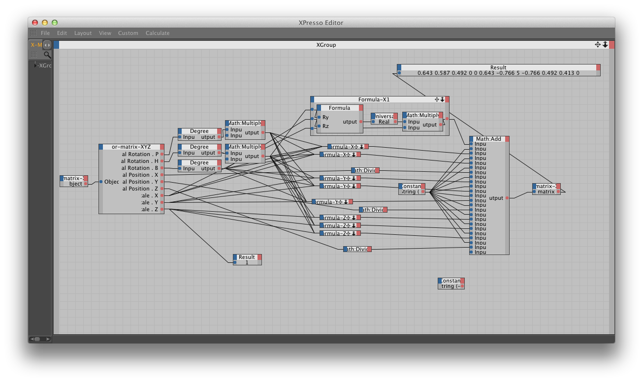

i agree with you about the more simplicity of a matrix calculation, but unfortunately i can't find any info on what kind of operation i need to do in order to transform the c4d global matrix into an octane one, the Z axes is inverted :(
the unique informations that i was able to find are relative to the trigonometic decomposition of the values of the matrix, so i've decided to decompose the c4d global matrix, take the translation as it is and recalculate the 9 digits of rotation via formula.
but don't worry it's more easy of one of yours beatiful procedural octane materials :D
it's made by nodes, so is extremely easy to trasform and elaborate, and they are also groupable :)

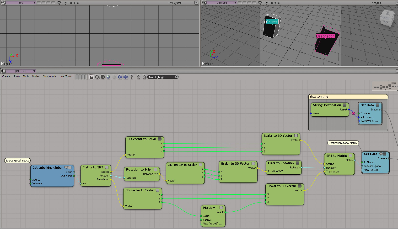

If you can read and write an object global matrix, there is no problem.
Seperate each value and multiply the z position with -1.
After that, connect each value to the new matrix.
Here a screen from Softimage...

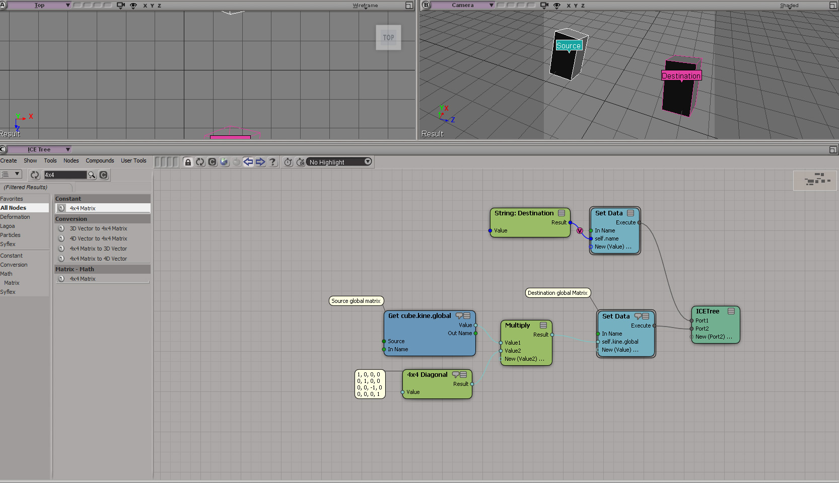

If you want to mirror the global transformation matrix on axis z, multiply the matrix with an other on with negative z-scaling.
Like this:

Posts: 10591
many thanks face, those screenshots are really useful :)
i'll try to reproduce them with xpresso, thanks again ;)

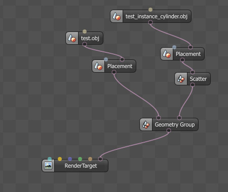

Why a geometry group can´t render from the command line?
Have build this setup:
The scene has the name test.
Exported mesh is test.obj.
After starting Octane, the rendertarget node is used with the -t command, but only the test.obj is rendered, before the placement.
Commandline is:
-m test.obj -r "G:\Octane\ProjectA\test.obj" --cam-up-x -0.153499 --cam-up-y 0.902506 --cam-up-z -0.402395 --cam-target-x -0.0449646 --cam-target-y -0.0413809 --cam-target-z -0.0114845 --cam-pos-x 0.113271 --cam-pos-y 0.170481 --cam-pos-z 0.403327 --cam-fov 53.638 --cam-aperture 0.01 --cam-focaldepth 5 --imager-exposure 1 "G:\Octane\ProjectA\test.ocs" -t "RenderTarget"
I know, camera and imager aren´t used in my Octane setup, but it should render the same scene as when i select the RenderTarget by hand...
